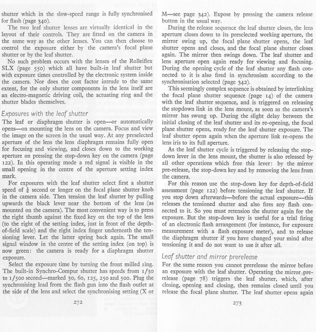

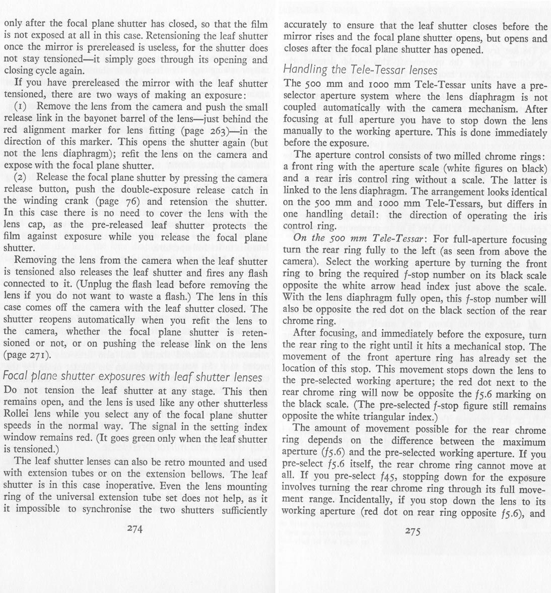

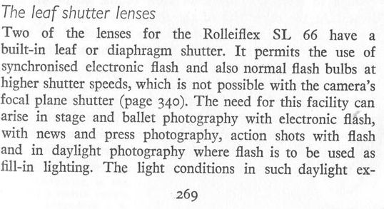

Some of what is written above is incorrect.
I will attempt to attach four files of scans from The Mannheim book about the SL66. I hope they are readable. Read them in order 1,2,3,4.

In the excerpt posted by @john_s I believe it says 1/4 second or slower for the SL66 - similar to my experience with the Mamiya 645.
It is an issue that arises because of how the mechanisms in the camera and the leaf shutter lenses are sequenced - which opens first, and when the second one opens in relation to the other. The 1/4 second or slower timing for the camera's focal plane shutter provides a sufficient "window" for the leaf shutter to go from closed, to fully open, and then back to closed again all within that period of time.
If you intend to take time exposures with the camera - longer than 1/4 second - it may make more sense to use the focal plane shutter only.
