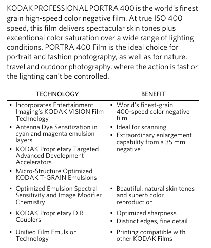

the 2016 Data sheet for Portra 400 does claim it uses "Vision Technology" whatever that entails

Incorporation of "KODAK VISION Film technology" is not necessarily the same as giving results that look like the results from "KODAK VISION Film".
Outside of things like fine grain.
