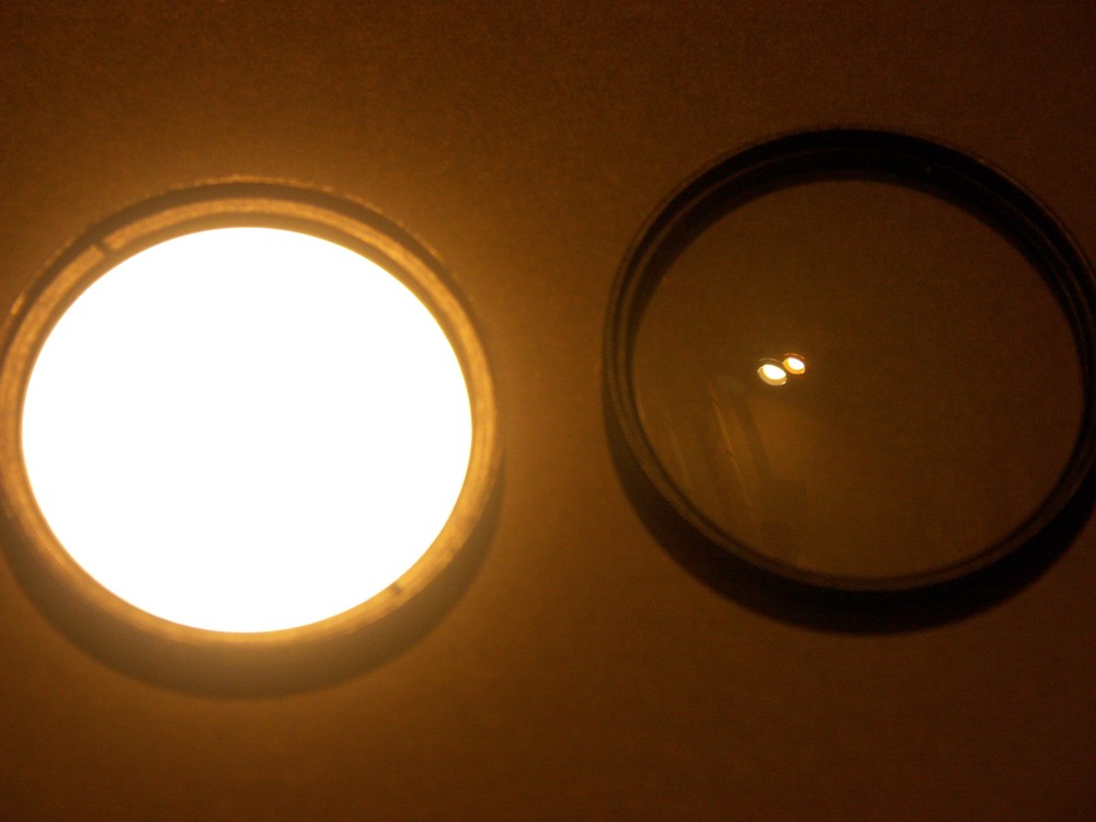

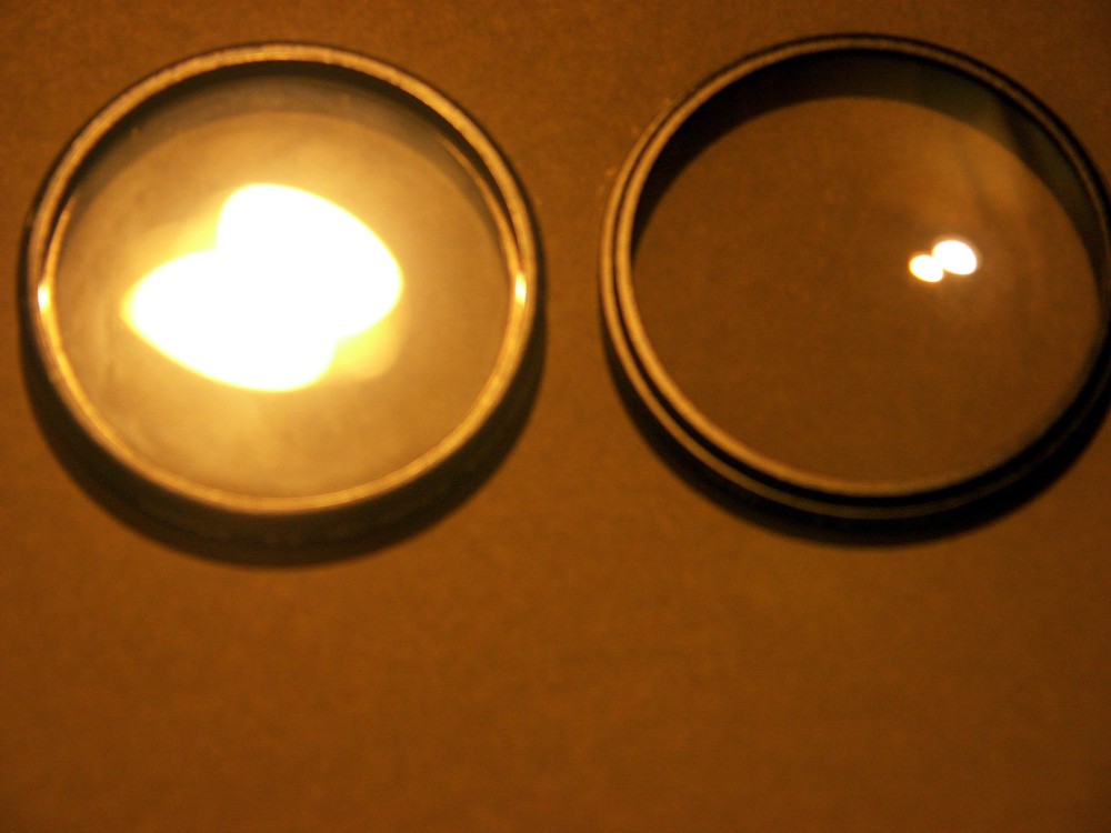

But I've run into a set of Ketnor close-up lenses that have me confused. They are simple, one-element lenses, but instead of being concave, they are pretty flat -- even though they create the appropriate close-up effect.
Here are two photos comparing the weakest #1 CU lens (on the left) -- first the front, then the rear -- to a Tiffen #1 (on the right). The Tiffen has the obvious concave shape, while the Ketnor does not. They both reflect TWO images of the single light bulb indicating ONE glass element.
The Tiffen shows the light bulb as expected, on both sides, but the Ketnor reflection suggests a nearly flat surface.
Can anyone explain the differences, optically? Is one better than the other???

I appreciate these comments, but I can't quite fathom how the Tiffen #1 has a strong curvature (concave on one side and a similar convex on the other) while the Ketnor #1 is basically flat on both sides. The reflections in the photos demonstrate this.
I understand how the curvature on the Tiffen bends the light -- just like all the other CU filters I've seen, but the Ketnor lacks this curvature -- yet they both magnify to the same extent.

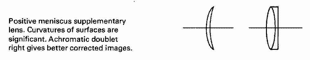

The Tiffen and the Ketnor that I'm talking about are simple, one-element, meniscus lens -- such as the CU lens in this diagram (marked #1.
The Tiffen #1 is exactly like this -- convex on one side and concave on the other. The Ketnor #1 is basically flat on both sides -- as confirmed by the reflections in the photos.
How can a nearly flat CU lens create the same magnification as a curved lens?

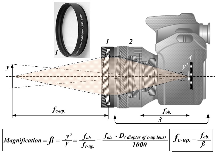

I've figured it out -- as can be seen in the diagram, A simple, single-element CU lens (left side) will have substantial curvature -- like my Tiffen. Much more than 2-3 business cards. An achromatic, two-element CU lens will be much flatter, on the rear, due to the additional element (right side). I had assumed that the Kelnor was a single element lens due to it's low price.
