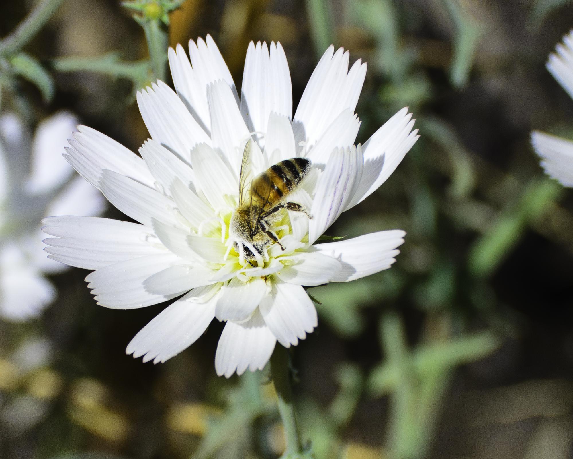

I have a Nikon 6T Close-Up lens that I originally purchased for use with my Micro-Nikkor 70-180mm lens (it permits a 1:1 reproduction with that lens). Recently, I used the 6T with my Tamron SP 70-300mm VC f/4 lens on my Nikon D7000 camera. I was pleased with the result. A photo taken with that combination is shown.
