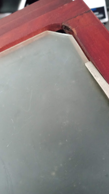

Another, more prosaic reason for clipped corners: some older cameras had cut channels for the GG that DO NOT extend to the corners. I had a full-plate (or 8x10, can't remember which) camera where it appeared that the cutting tool lifted up over the last 1/4 -1/2" toward all 4. The replacement GG that I bought for it didn't have clipped corners, so it absolutely would not go in. Good times.
Yup. Kinda like this (old Gundlach Korona)....
