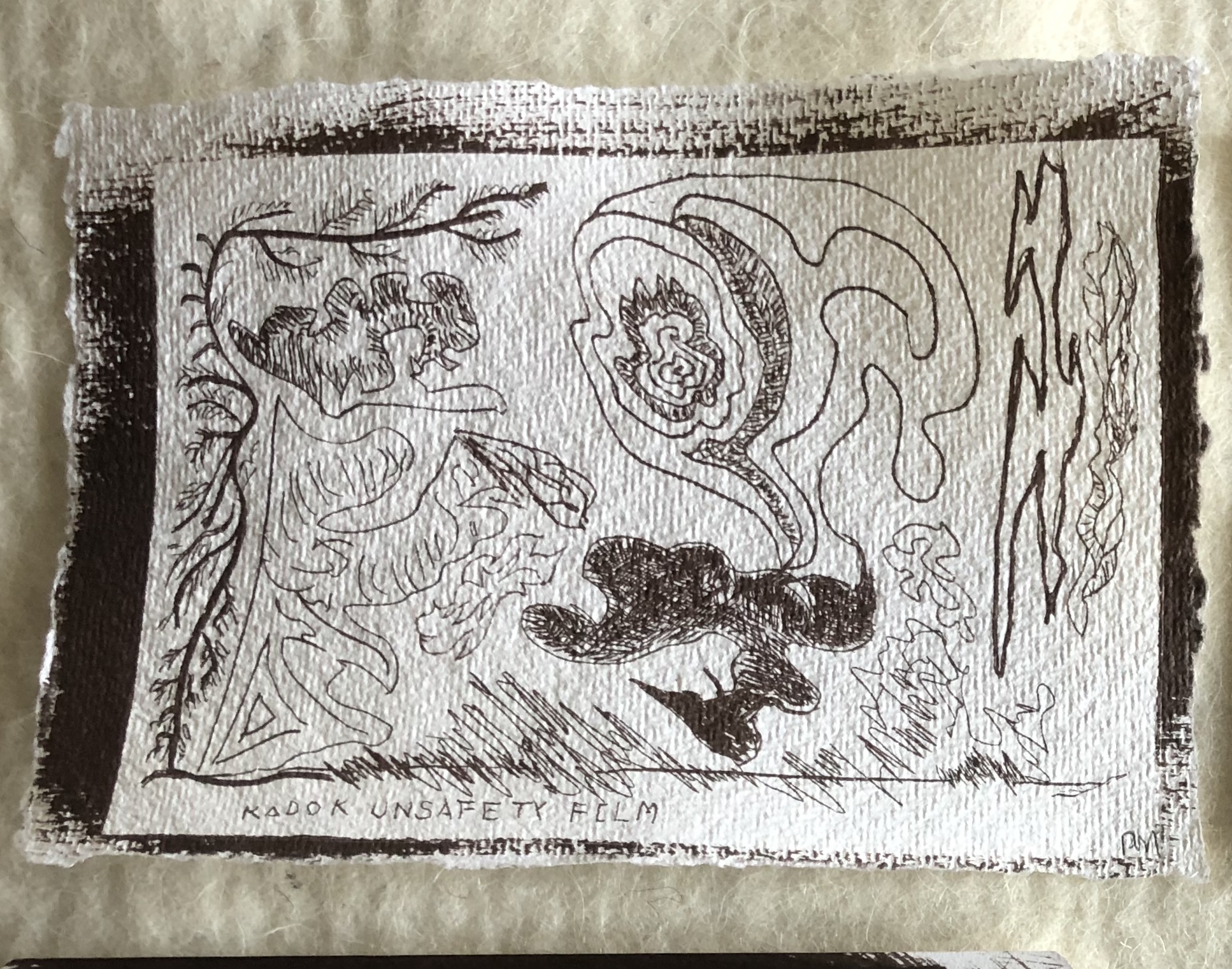

At the heart of cliché verre is act of drawing on a transparent material, really, nothing more profound than that. At the time the process became popularized, that meant using glass... the glass was simply coated with soot, which would then be scraped or scratched away to form a reverse image because that was easily available to make a "resist" on the highly available glass. If you weren't happy with the drawing, you could simply wipe the plate and recoat.
In other words, there is nothing intrinsically special about using soot on glass to make the print. I've been using laser printer overhead transparency materials, markers, and masking tape to do cliché verre with kallitypes and argyrotypes for the past two years now. The 4x5 print below is an example of an argyrotype created through cliché verre: the "negative" was created using a laser printer to print an opaque film. The drawings were then done using a needle (comparable to doing a dry point etching, hence some of the confusion with the process and traditional acid-based etching or intaglio printing) and enhanced or re-worked with a marker (the vertical, angular lines on the right-hand side were done with a Faber-Castell Pitt Artist Fineliner).
If you're considering making the drawing more permanent for further usage, I'd suggest re-consdering the use of glass and soot. Or if your goal is an image on glass, then traditional carbon transfer or any number o other "subbed" photographic process would work fine. But the point of the soot-coated glass plate used in cliché verre was to create a negative matrix to use for printing a photographic-based image, not the work on the glass itself.
Gold-toned cliché verre argyrotype, +/- 4" x 5", June 2020.

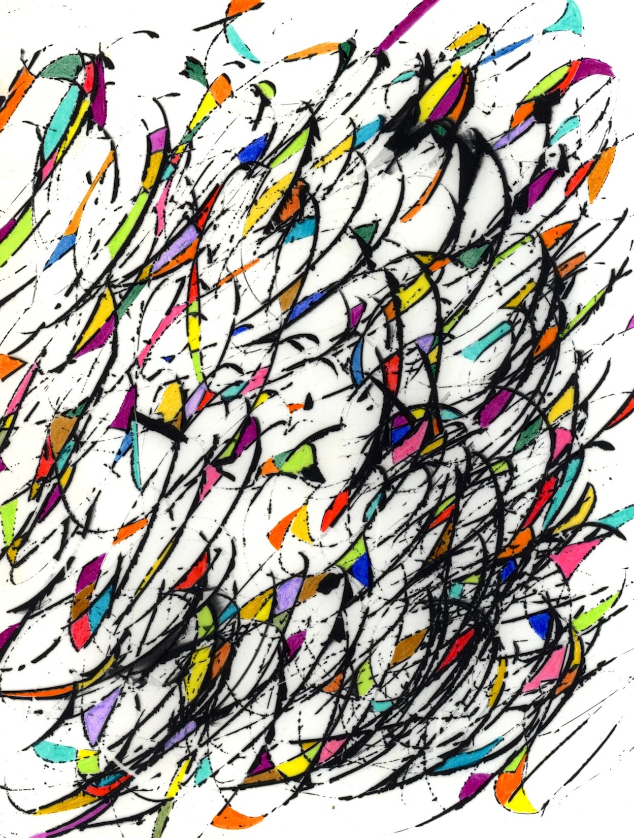

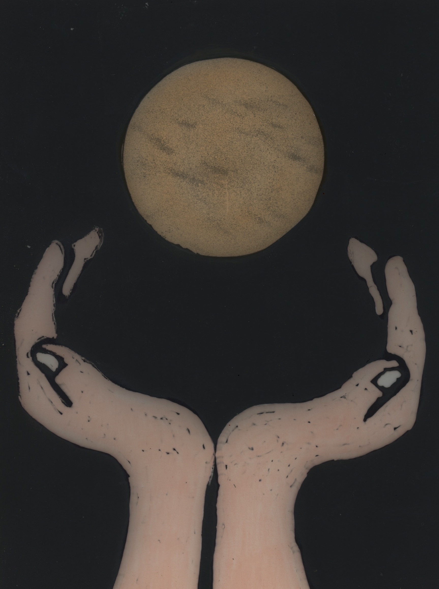

I do mine with a negative developed to full density or a completely clear negative. I'll scratch the surface of the dense negative, or draw on the clear one. Here's an example of each (I hand paint the prints):

Never heard of such a thing, interesting. Looks like it's the predecessor process to digital negatives.
