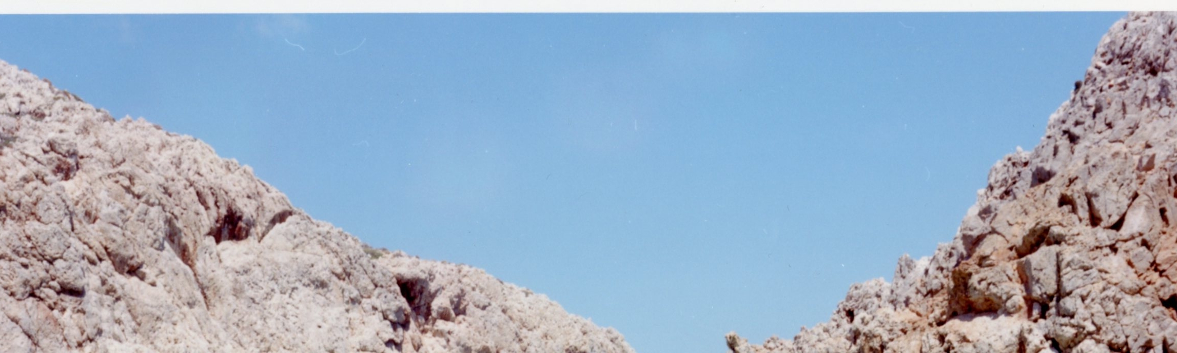

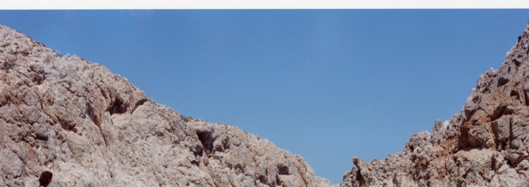

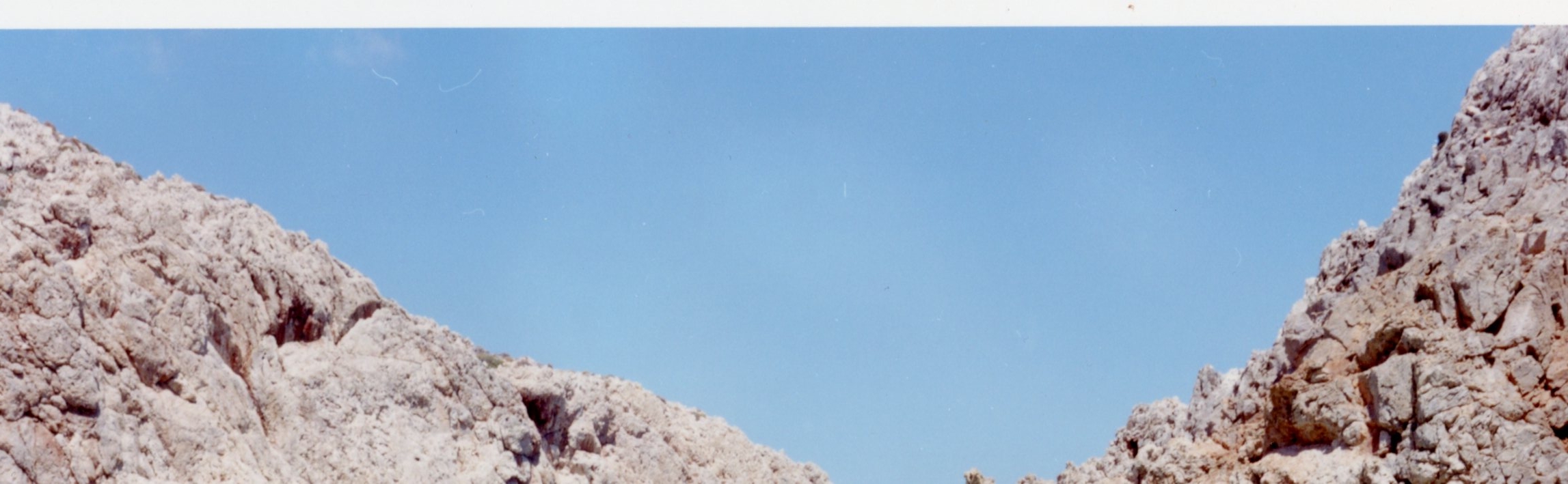

hello,
any idea about what could cause the white stains i get which are visible in the skys?
if i repeat the print sometimes they are there, sometimes not. i attach 3 prints where they can be visible with different degree of intensity.
background information.
i print with drums (durst codrum 205, 10x8 inch print, i have a few of them), at 35 degrees C, single use (so , no possibilities of chemical contagion).
steps are:
1) pre wash (to heat paper)
2) develp 45 secs
3) stop bath 25 secs (2% acetic acid) and 20 secs water to rinse
3) bleach 45 secs
4) wash
use bellini ra4 chemicals
i pour 50ml and agitate with durst comot (levelled). i got the stain even if i pour a bit more of 50ml
i already blackened every light that comes from the sides and back of the enlarger.
i print with a durst modular 70 colour head, mainly 6x7. i use a 80mm rodenstock componon-s which is supposed to be correct lens up to 6x7.
i imagine if the problem was the enlarger/light/lens should it be in any print?
i use an easel, which i cleaned well, and if it is the easel i should always get the stains i think
i did cut the paper by myself. i was thinking maybe fingerprints, but i did use gloves, and the "stains" don't' look like fingerprints. or they do?
the other thing i was thinking could cause the stains is maybe light leaks from some of the drum i use. but do they look like leaks? stains should be darker not clear if it was ligh leak? and i did get them even if the sky was toward the bottom of the drum (not the lid) .
any suggestion about where to look and how to solve the problem?
thanks a lot
stefano
here some print details where the problem is evident. stains are not in the same exact spot from one print to another. sometimes problem does not appear.

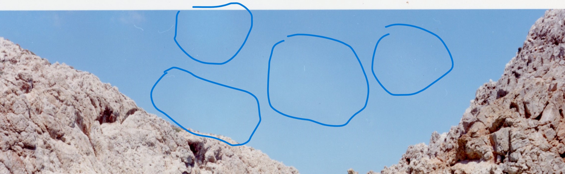

i realized that stain maybe are not so easy to spot from the scan if you dont know where to look. the stains are quite big. so now i post the second print with circles around the main stains and then without the circles so you know where to look for the stains

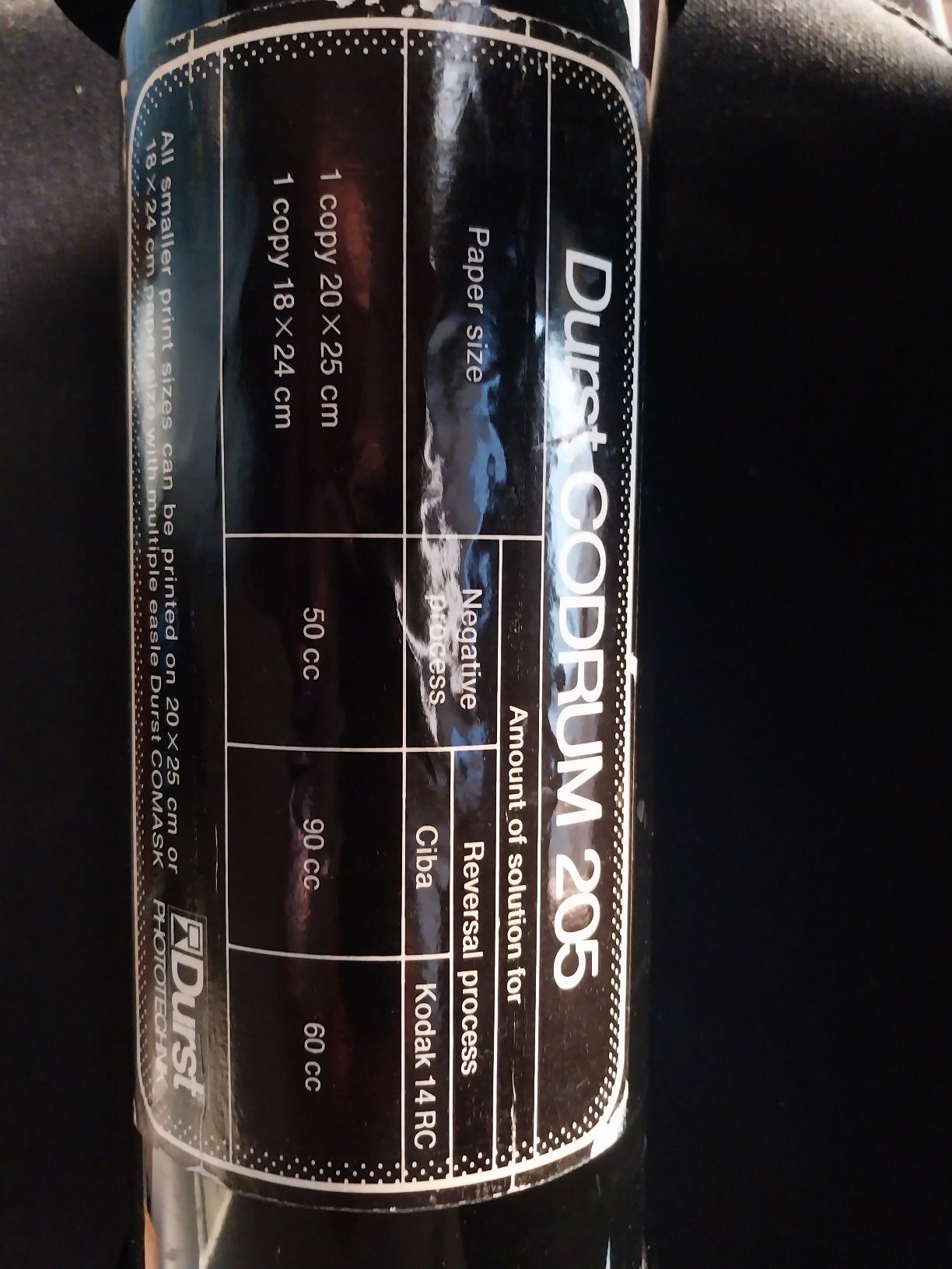

I have searched the internet and nowhere can I find the amount of print developer for an 8x10 Durst 205 Codrum I found a drum on e-bay and while the outside of the drum specifies amounts for negatives and both Cibachrome and Kodak reversalI coudn't work out the amount needed for an 8x10 print
As it is meant for 8x10 negatives one might assume that the amount for negatives apply and it does say 50ml. So on that basis the OP's use of 50ml might be right but it might be as well if the OP were to try and discover the amount, if he can
pentaxuser
I will do a test in a few days. The durst codrum 205 drum says 50 cc for negative process.
I used them a few years ago without a problem but I dont remember if it was with 50 or 100 ml. At that time i was using durst coterm to heat the chemicals. Since the small jars in durst coterm are 100 ml it might be i was using 100 ml.

Yes what I saw is exactly what you have shown in #16. If this is a drum that is designed for 8x10 be that film or prints then my logic says that a 8 x10 negative is the closest to an 8x10 print and an 8x10 negative is the same size as an 8x10 print and b&w prints can even use developer that is more commonly used for negatives
If the print needs substantially more than 50 ml you'd think that Durst would give it a separate column which it doesn't. If lack of developer in terms of quantity is the cause of your problem you'd expect it to be there in every print and as far as I can see it is confined to the sky area only - at least in the prints you have shown us
We're looking at one little snippet from one print. Moreover, sky areas tend to be of uniform tone and slight variations show up more clearly in those areas even if they're present across the entire sheet. If you print an entire frame of rock formations like the little bits we see on the snippet as well, a problem like this will go entirely unnoticed.
pentaxuser
Durst codrum should be just for prints, not negatives. So the way i read it is negative process stands for ra4

The stains are visible (and not so easily) on the skies, but you are right that they could be also be present in the other parts of the print but not be visible because of the texture
