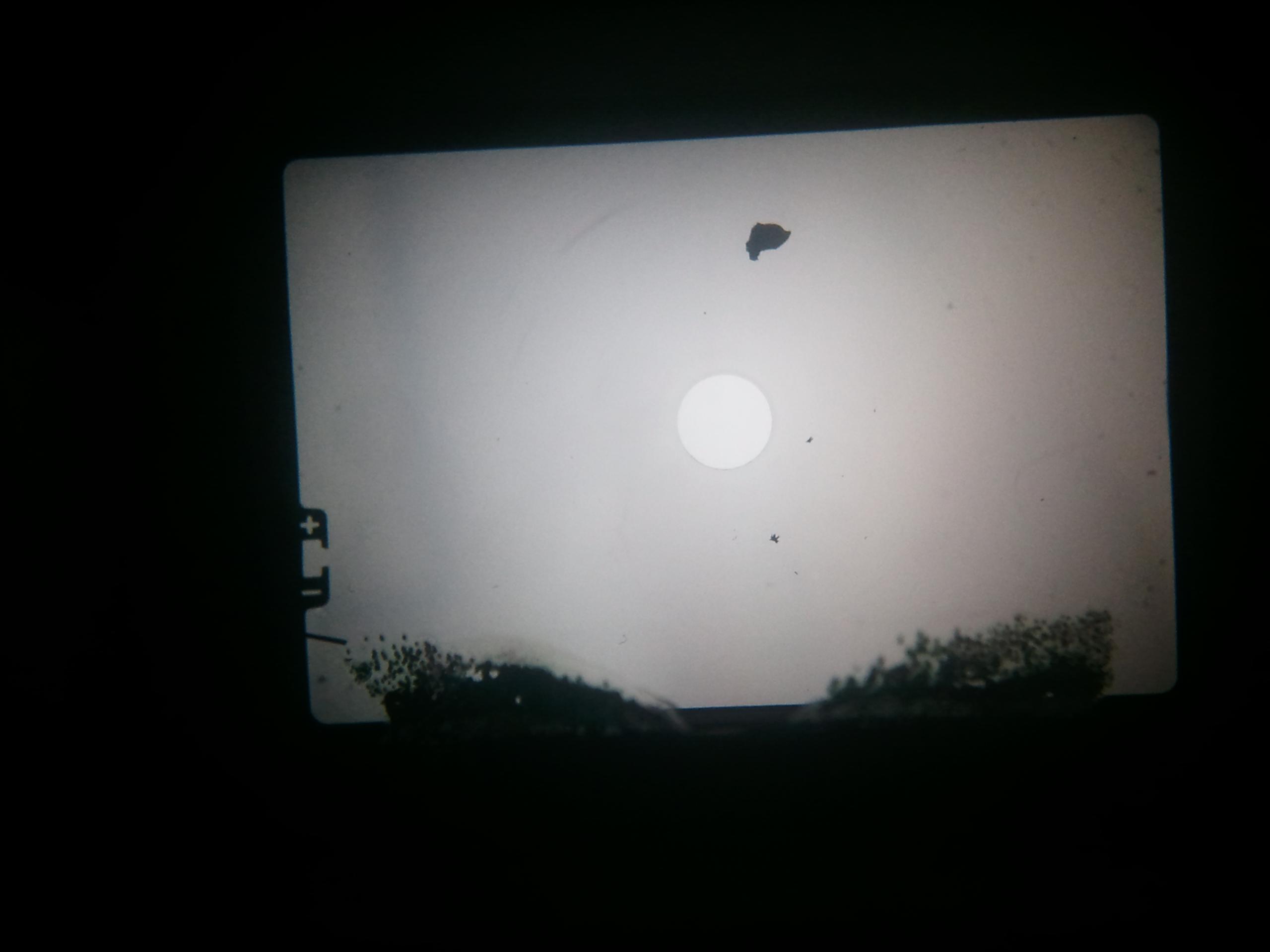

I decided to get into photography and decided to start with an olympus OM-1. I bought it on the internet, and after receiving it, I noticed what looked like foam in the viewfinder. Would this cause problems, and even if it would not, would it be difficult to clean out?

Sure looks like foam stuck on the viewing screen. Take off the lens and look. I'd guess the mirror is all sticky as well and any other foam seals need replacing. Cleaning it off the screen is not much fun. it's very easy to smear it around and get it embedded in the Fresnel lens and never get it off.

It could also be that foam has degraded the silvering of the prism. This is a common problem. I have a OM2 that I've had to replace the prism.
If possible I would return the camera.

Unfortunately, I can't return it, from looking at it without the mirror is pristine. I see a what appears to be the detached spot on the hazy white glass that is above the mirror, but I was unable to see anything that would have caused the bottom part. Does this sound like it would cause any problems to the photos, because if not I am fine with keeping it the way it is.
What happens is they use a foam seal where the pentaprism joints are. The foam deteriorates and eats the silver off the mirrors in the prism.
This issue does not effect what is recorded on the film but can make composing a bit annoying. I guess you can get used to it.
I'd inspect the back foam seals and also the mirror bumper foam as those have probably gone south also.

Thanks for all of the advice. I was already planning on redoing the foam, figuring that they would have deteriorated with so much time. I'm relieved that those spots shouldn't harm the pictures, as long as too much light doesn't get in.

There are instructions on the web for replacing the prism; apparently not too difficult a task. Replacement prisms can be sourced from later, cheaper OM bodies (OM-10 or OM-PC, I can't remember which) which can often be found for pennies if not functioning. You might want to keep an eye out for one of those and pick one up if you find it.

If it was paid with Paypal and the seller didn't reveal the damage in the prism, It can be returned if you make a claim with PP for item not as described.
The light seal in the body are easy, the damaged prism, not so much.

The prism rot is common but won't affect the photos. When you clean the camera, find the web site that shows how to remove the top plate and get that old foam out of there. You have to be real careful since there are delicate things in there and you don't want to drop any of the foam crumbs into the viewfinder.
