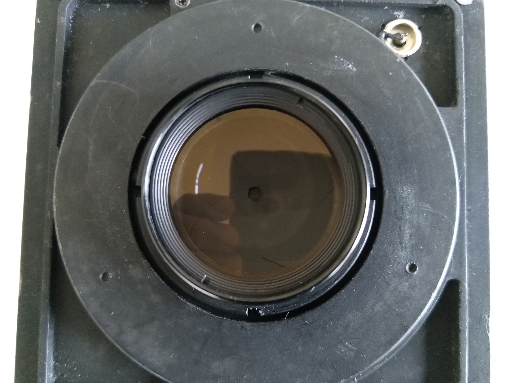

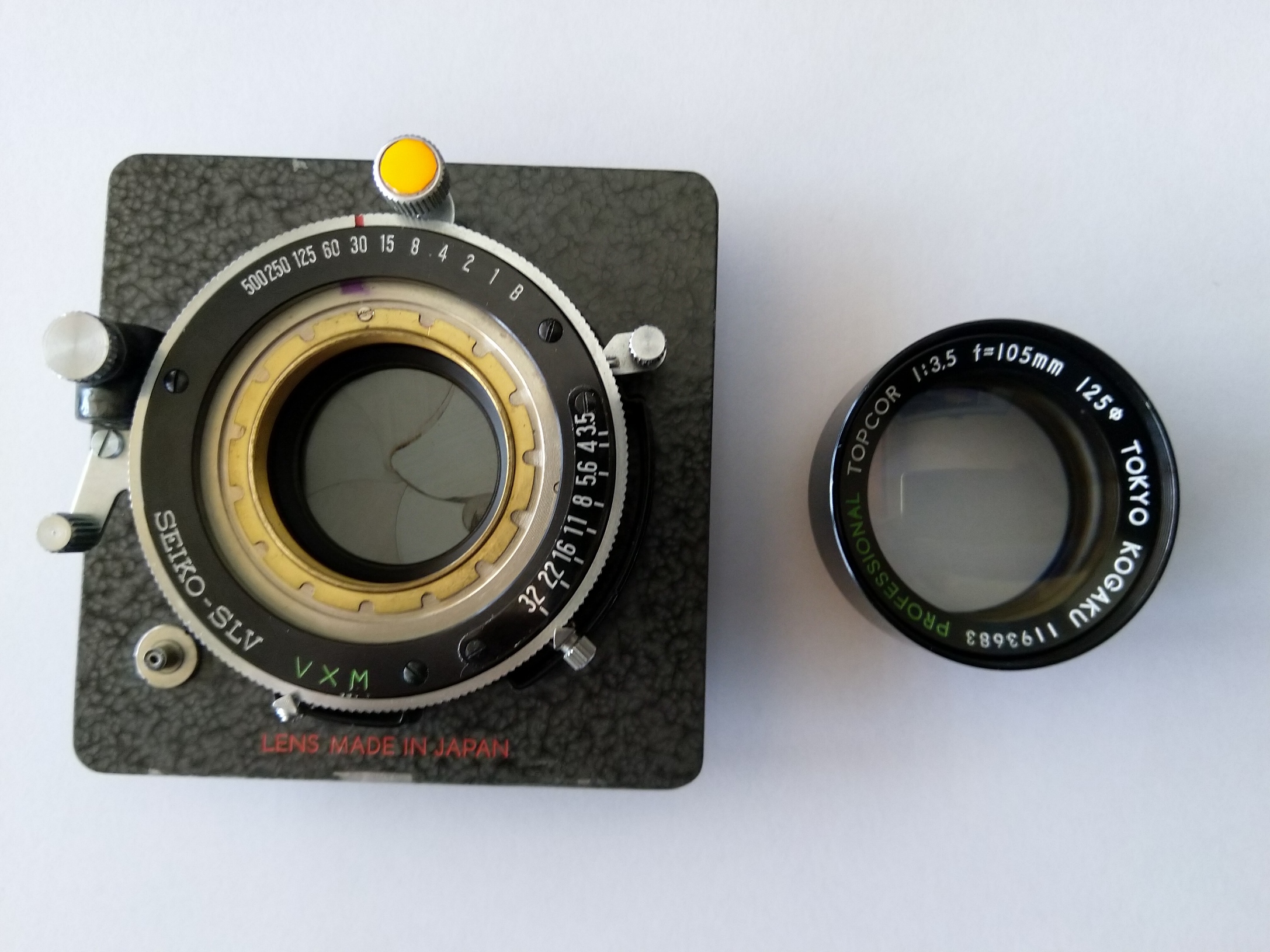

Does anyone have a link to a step-by-step tutorial on dismantling and cleaning a view camera lens? Horseman type board, with protruding flash contact would be ideal.
I have a spot of dust that appears to be in the rear element of a Topcor lens with a Seiko shutter. I wanted to be sure that I could risk taking it apart as I'm a view camera lens cleaning virgin.

UPDATE: I decided to use my brain, and a modicum of brute force, and managed to unscrew the front element. I then opened the aperture to max (f3.5) and blew out the dust on the rear element. Who knew it was so easy? Not me. I've now cancelled my order to Amazon for a spanner wrench, which I thought was needed to remove the rear element.

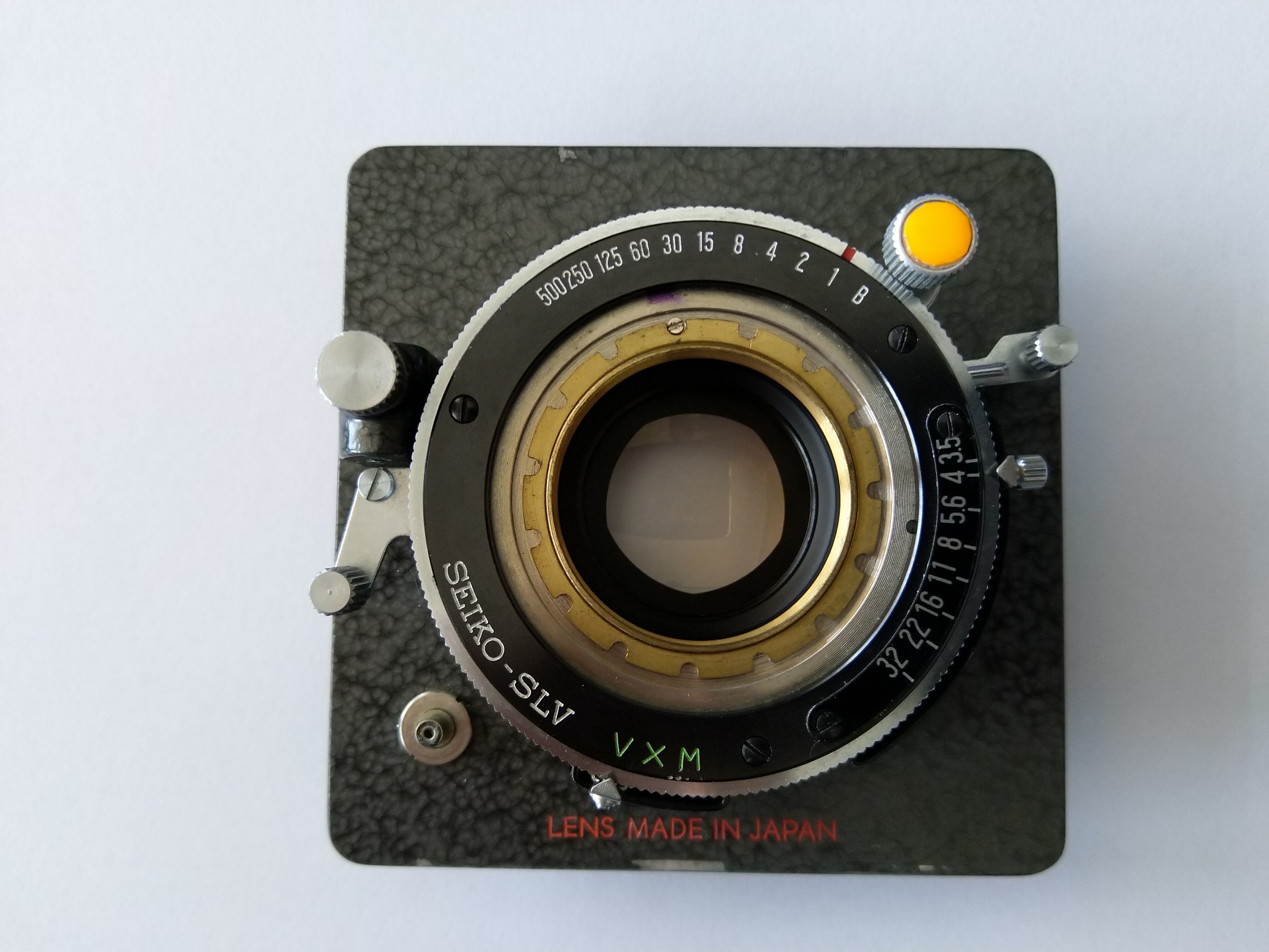

Thanks for your reply - it's much appreciated. There does seems to be a retaining ring around it, but I'm not sure what it's retaining (see photo). It's certainly not wanting to move with hand pressure (not mine, anyway).

Hmmm...odd. I've never owned that specific camera and was extrapolating a bit....
Those inner retaining rings hold the individual pieces of glass in the metal tube (I'm grasping for the right words here, sorry) and those pieces of glass in that tube are what I'm calling the rear group. It should be fairly easy to unscrew the whole rear group as an assembly. There is another retaining ring that fastens the shutter to the lens board...but, It's not clear to me where that is in this photo. Finally, the whole rear group should unscrew by unscrewing that tube from the back of the shutter. It looks like the rear group is short and not protruding very far from the back of the lens board and perhaps, one would need a jar opener (a thin, sheet of rubber-like material) to get a good grip on the rear group.

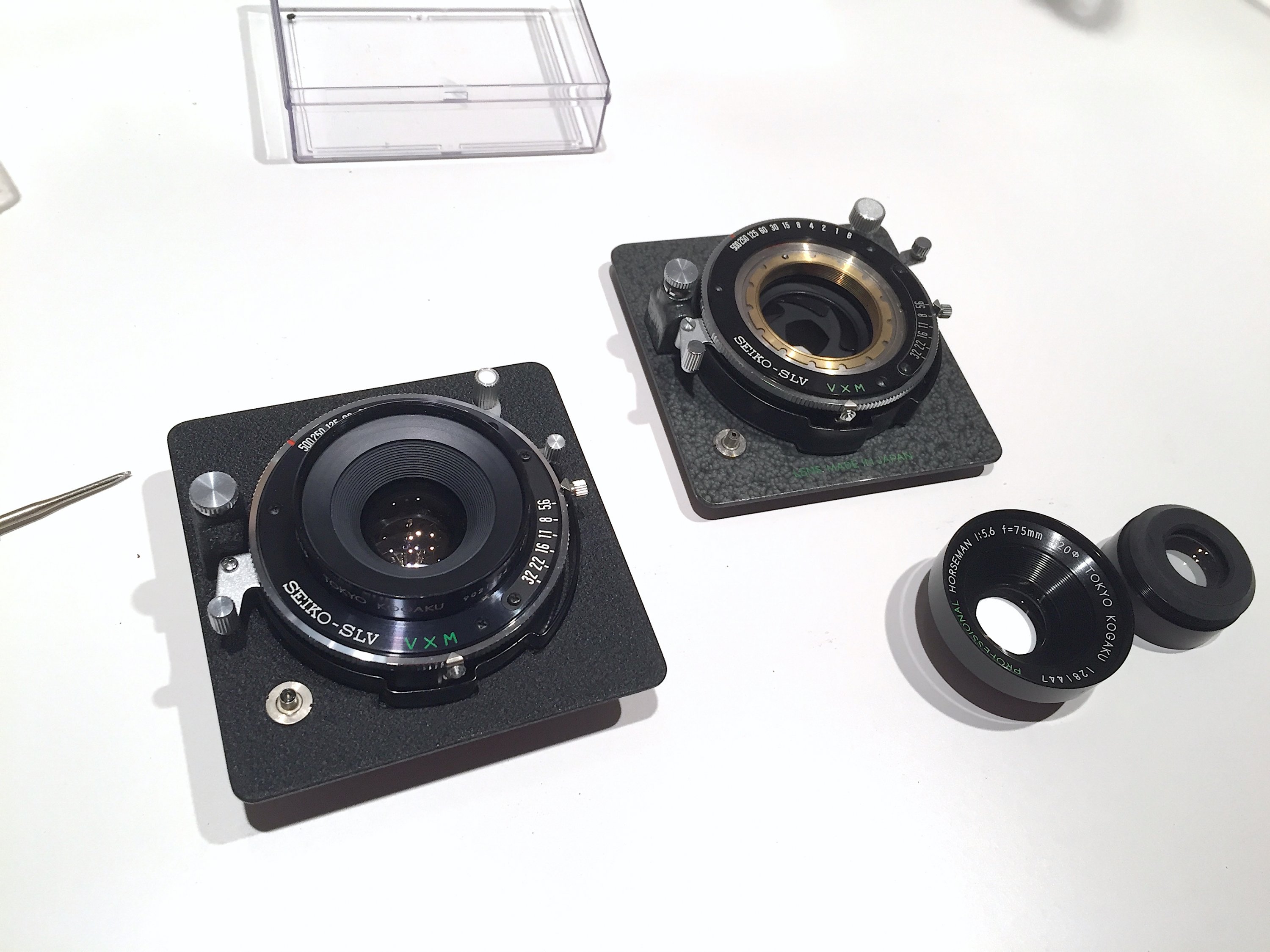

The Horseman/Topcor lens, from the back, will be like most other large format lenses. There are 3 things that unscrew. Outer item is the retaining ring for the Seiko shutter. Next is the entire rear cell that unscrews like the front. Inner is the locking ring for the rear cell lens elements.
However, unlike most other large format lenses, swapping shutters, lensboards and lenses is not recommended.
Each lensboard provides the lens with a certain flange-focal distance for the rangeifinder (color coded on the SHUTTER cock lever).
Also, the early (inner letters) and later (outer letter) lens cells are not interchangeable. They changed the threads.
The parts on these two Horseman 75mm lenses are easily not interchangeable and the lensboards provide different flange-focal distances. The shutters may look similar but, in addition to different threads, one uses a push-pull lever to open the blades and the other uses a up-down lever.

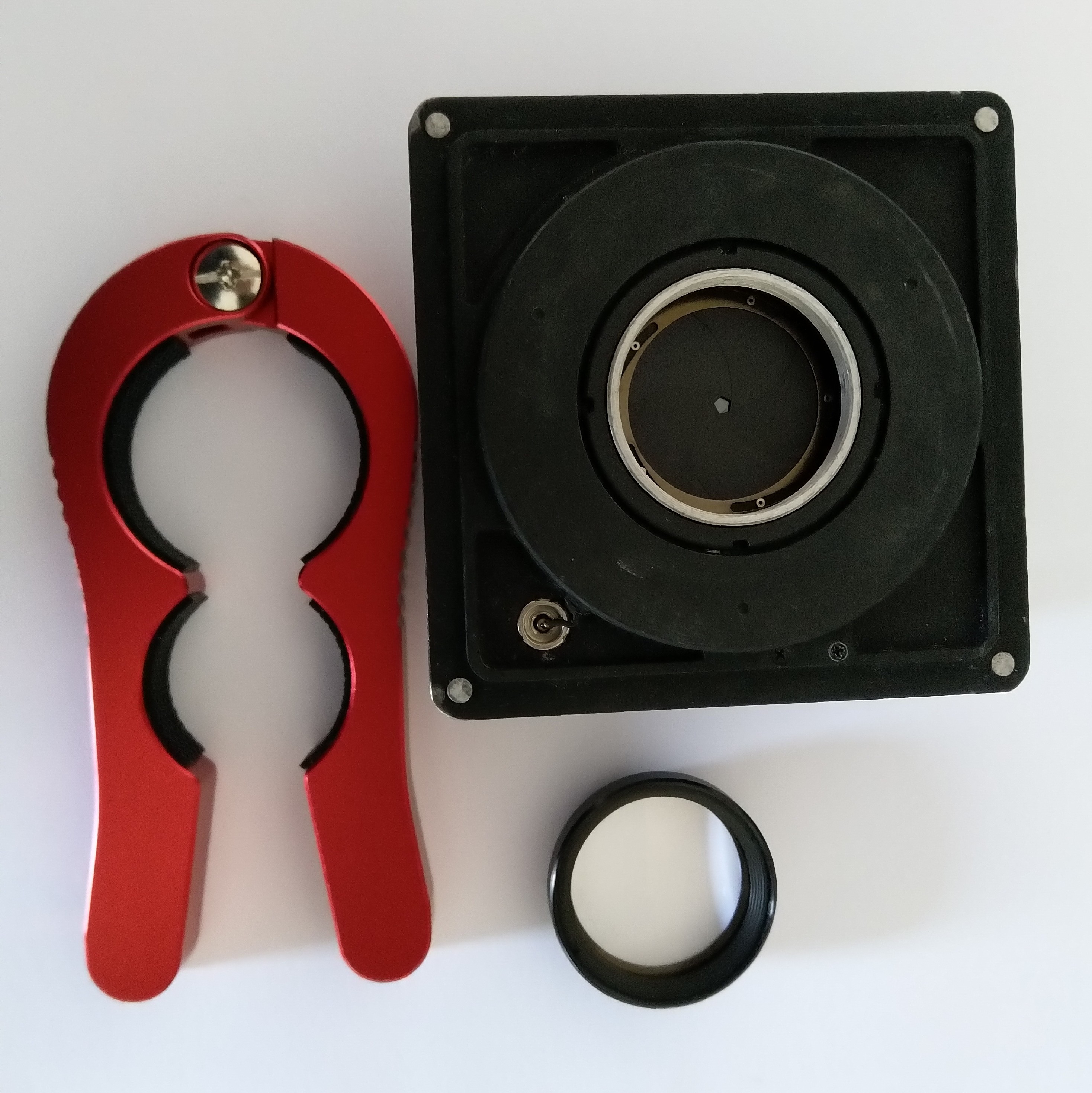

UPDATE: Just coming back to this thread, after receiving a filter remover from Amazon. I actually bought the wrong one, as this is a smaller size intended for drone lens and filters. The good news is...1) I own a drone and 2) it's a perfect fit the but element groups of the Horseman lens. Got the rear element group unscrewed in seconds. The bad news is...I may never use it again. But it's a nice thing to have on the studio table.

Many of the Horseman lenses share the same rear lens cap, and thus the same diameter, so 'never say never...'
