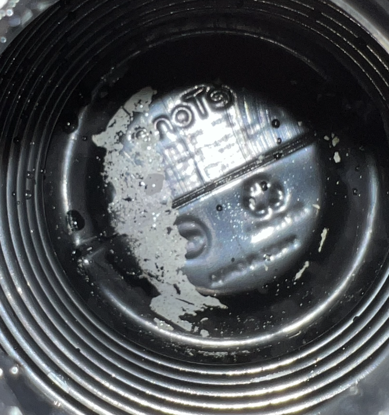

The bottle I use for fixer (color, cinestill c41 kit) has a layer of silver at the bottom that won't come off with regular detergents.
Can I still use it to store and reuse fixer? If not how can I remove this layer at the bottom?
Is there a way to prevent buildup of deposit?

Step one: Chlorine Bleach (diluted) This will rehalogenate the silver into silver chloride
Step two: Rinse. Removes the excess chlorine
Step three: Fixer. This will fix the silver chloride and make it soluble.
Step four: Rinse well. This gets rid of everything.

Thank you so much! So after step 3 I have to get rid of the fixer I'm using to clean the bottle? I will do that when my fixer gets to the end of its lifespan, thank you!
You'll also form silver oxide. Which is probably not a big issue since it'll likely float away. It doesn't dissolve and won't plate out back on the walls of the container.
Yes, you can still use the container to store fixer even with the silver plated onto the walls. However, I'd recommend filtering the fixer before use, since the silver has a habit of crumbling off of the walls of the bottle, leaving tiny flakes that embed themselves into the emulsion of the film you process. So cleaning the bottle is a good idea.
It's also a good idea to not overuse your fixer. Personally I don't re-use fixer and instead use a more dilute fixer one-shot, so it's discarded after a single use. No more problems with plated-out silver. Fixer is relatively cheap, so I find it a worthwhile compromise.
