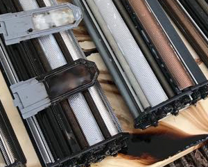

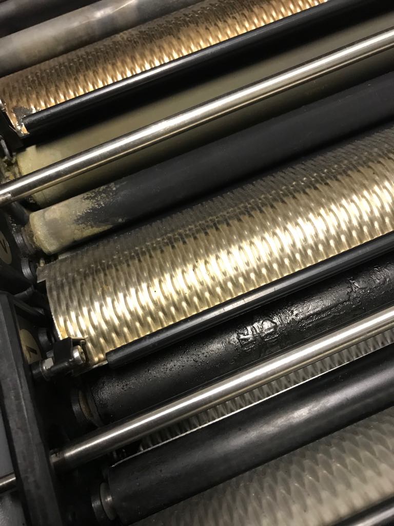

Hi,
recenlty I bought used Thermaphot ACP505. I am using AC200 for some time now so I am familiar with the system. ACP505 came, I knew from previous owner that it had not been used for 10 yaers or even more. Condition looked pretty nasty, yet all worked well. Engine all the rollers in 5 tanks as well as the dryer. I cleaned the circulation pump so it works as well now. Replenishment does not really work but I suspect it's because of dirt in pipes. Yet the question is how to properly clean the processor?
I suspect processor was used with different proccess for color prints than RA4, don't really know the name but as I heard before RA4 there was process which was really dirty. Looking on the tar on rollers and edges on tanks it was something diffeent that modern RA4.
I used whole bottle of Tetenal Chem Cleaner (1L). It works pretty well, in one second it dissolves the outer layer of tar. But the tar seems to have no end.
In my local shot they offer as well Chem-Kwik Cleaner - anyone has any exprerience? Will it be better than Tetenal Chem Cleaner.
I just wonder what's the best chem out there to fill the processor with water add cleaner and run it to wash the mashine as good as possible. Now the best result I get after spraying Tetenal Chem Cleaner over the racks, wait around half of minute so the chem does not dry and wash racks with warm water. The thicker layers of tar was erased with sponge and chem but I realized sponge cleaning is not that efficent because chem looses strenghts fast when it starts to dissolve the tar. So just chem spray, wait and rinse.
I add some images, the last it after some cleaning, it might not show the results properly but it's way better that it was in the begining. Still need more... Thanks!!

Scotchbrite pads, very hot water and a lot of scrubbing will be your best bet. Keep filling it with hot water, recirculating and scrubbing the rollers; dump and repeat.
One of those rollers looks pretty bad; you might have to find a replacement for it.
I would pull the racks, disassemble them and scrub everything in hot water.
It may seem a hopeless task but it should clean up.
You MUST keep the machine rollers clean to have good prints, so carefully clean it after each use when you get it going. If you do clean the machine properly now, it should not be terribly difficult to keep it clean with minimal maintenance.

As has been mentioned, one of the rollers looks bad. It will get worse by expanding, usually at the ends and will cause slippage of the paper transporting or cause a paper jam. Replacement is best.
For tar, I have found spraying methylated spirits (denatured spirit), leave then wash with a soft cloth, then rinse, has worked for me. Test it first on a small portion of the roller.
