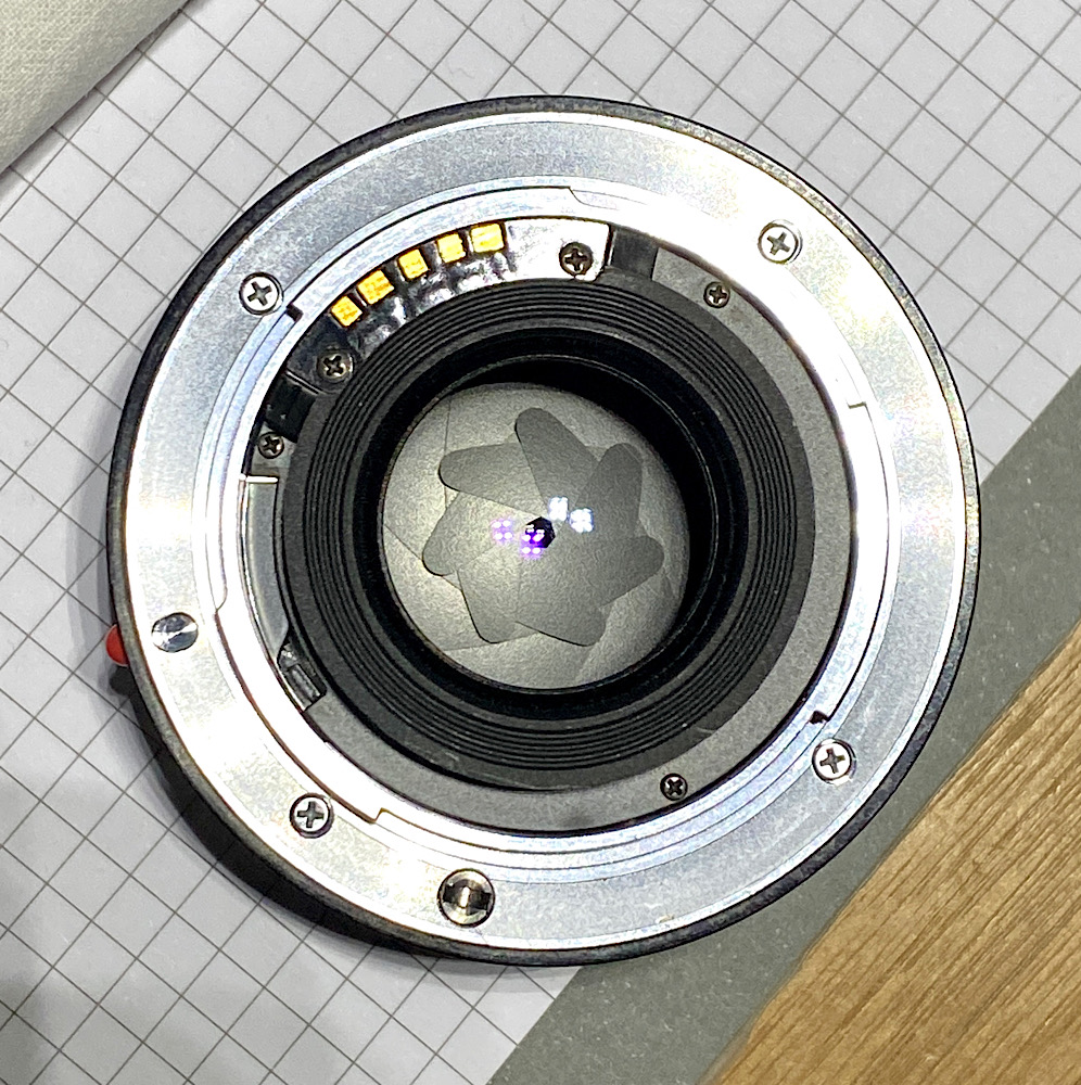

I would start by loosening the two small screws on the inside and the black panel should come off. Then remove the contact block if necessary. If that doesn't help, I would unscrew the bayonet.

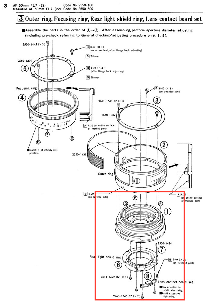

I made some progress. Getting at the oily blades was pretty easy. No need to remove the electrical contact plate -- it comes off by removing the rear cover. Then the rear lens group is held in place by three screws. BUT, when you remove the rear plate a TINY spring falls out. Lucky I saw it. It's right next to the "7" in the red box (above). The service manual just labels it as "spring", but my guess is that it is an electrical connection -- perhaps a "ground". It fits into a tiny socket on the inside of the rear plate.
As to the oil, I've never seen blades this oily. After four cleanings, it's still oily -- too oily. My guess is that the blades are somehow. mysteriously connected to the oil fields in Saudi Arabia.
xkaes
Mar 25, 2006
4,984
Colorado
After about a dozen tries, the aperture is working correctly. I still don't know what all that oil was doing in the lens. And I still have to figure out where that tiny spring is supposed to go. It's so small, I can only pick it up with tweezers. I hope I put it back in the right place.
