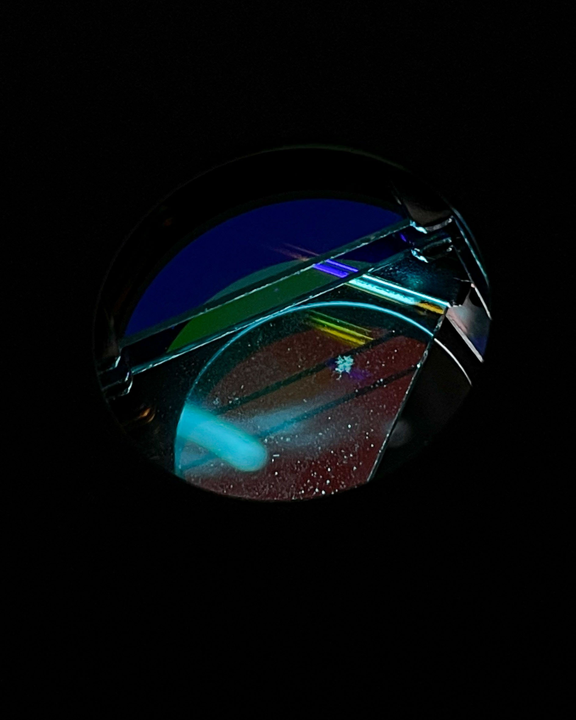

I'll be tearing apart a new-to-me dichro module and hoping someone could share a bit of guidance with a couple of things.
When running through the ranges, I have some sticking in CMY with M failing to engage past 120 at all. Is there a recommended lube (heh) for the dichro lever mechanisms? Powder or liquid? I want to make sure I'm hitting it with the correct lube/location after cleaning.

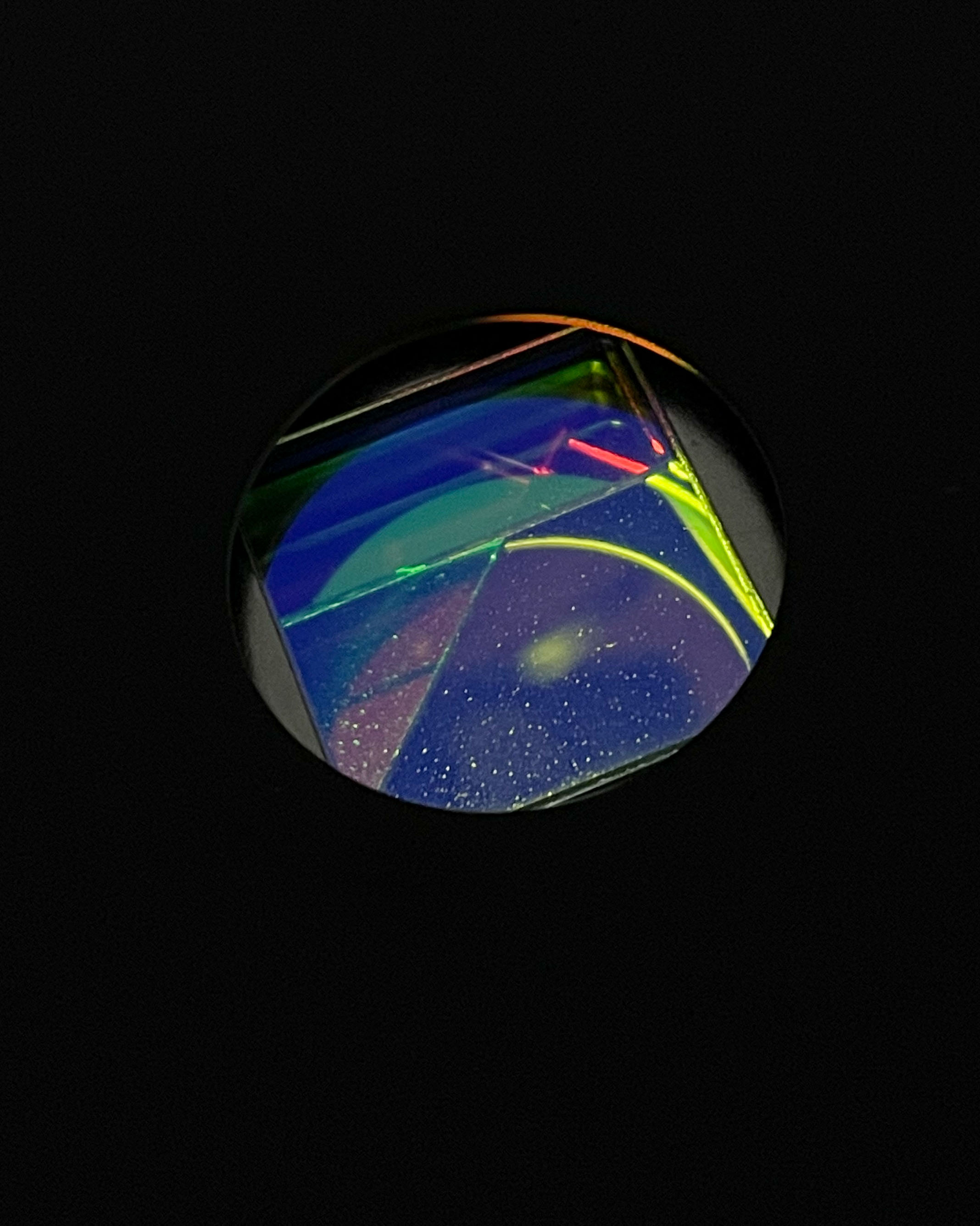

Cleaning the dichro filters. Probably the most daunting task. Dust. Fungus. Is there a chance at restoring this or a pipe dream?
Appreciate any help!

I'd not worry about the dichroic filters, most of the time you will be printing in the middle of the range.
The mechanism to engage and adjust the filters does need to work flawlessly. Carefully disassembled, cleaned and put back together.

BTW, don’t freak out if you discover cracks in those dichroic filters.
