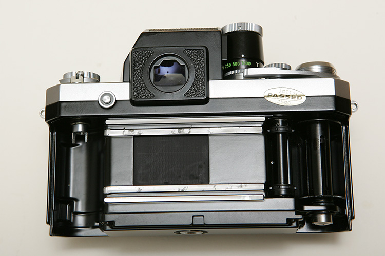

Hey everyone,
I recently acquired a cosmetically clean Nikon F but the film guides have some crud on them.
Best I can surmise is film was left loaded in the camera for a loooonnng time
and some emulsion has adhered to the film guides.
I tried cleaning very carefully with isopropyl and a q tip to no avail, so I
need to either go to a stronger solvent or buff it off somehow without damaging
the smooth rails.
Film transport is fine but it does scratch outside the image area and that cant
be good even if the image is unaffected.
I posted this to the Nikon repair yahoo group but it's a generic repair/problem and things move slow sometimes over there.
Any recommendations?
Thanks,
Bruce

this is what I'm working with.
Cgw,
It is outside the image area but scratching the emulsion and I thinking over time I don't want that scraped off emulsion getting in the shutter pulley etc.

Ugh...Can only think if you try scraping, make sure what you use is softer than the film rails. Marks on the shutter foil? Looks like someone's already tried.

Scraping will be my last resort.
I was hoping buffing somehow but then there is all the dust etc.
Yea, I never noticed the shutter marks, looks like someone squiggled a pencil eraser on the curtain.
Crazy the stuff flash can pick up.
I picked this up off the bay of course and need to evaluate if I should return it.
It's a drag cuz the exterior is perfect.
