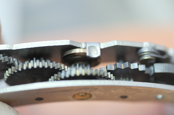

Synchro Compur delay timer spring at full compression.
