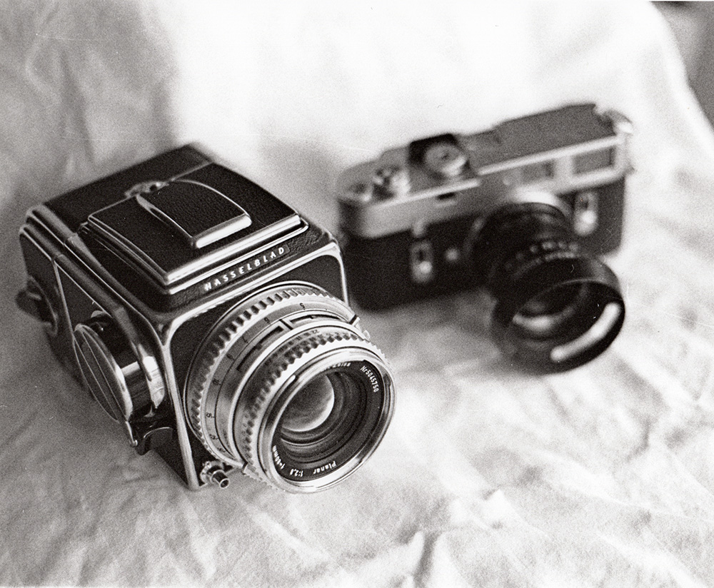

Ok boys and girls, I have looked at the results in the enlarger and the grain structure is somewhere between FP4 and HP5. Seems to have a very long toe and a hugable belly. I set up my Blad next to my M4, because I like shiny things, on a crumpled up white pillow case. Have a wide tonal range in the setup. Should be interesting to see the print.

Ok here is the test image I did. I did no burning or dodging on the print. I was simply looking at how the film would hold shadows, highlights and midtones. Plus how grainy it would be. Well the print showed very little grain compared to when I shot it at 400 asa and souped it in HC110. The northern light from the dining room was soft. For a film test I think it hit all the bases. I was at f2 on my 50mm Nikkor f1.4 MF lens. Plus I was crammed into a corner so if the focus was off it was due to my swaying a bit.
So what do you think?
