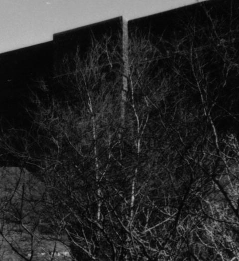

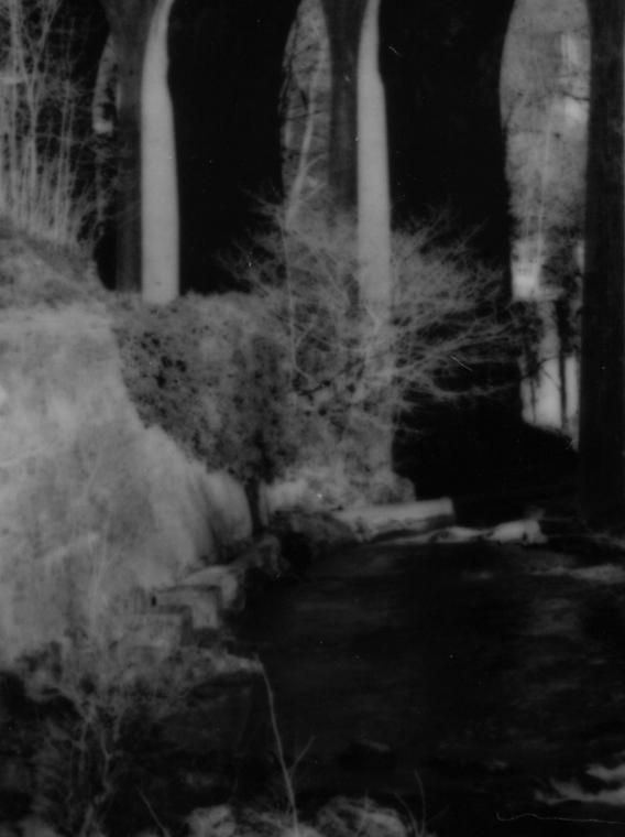

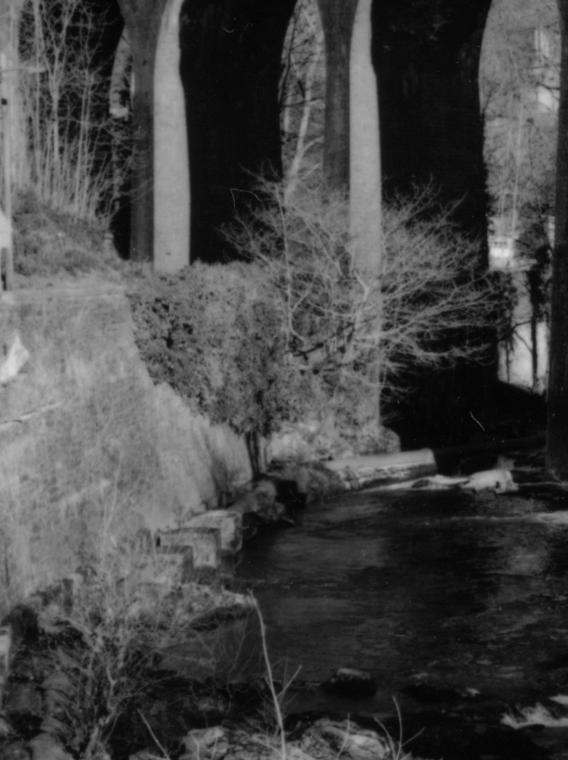

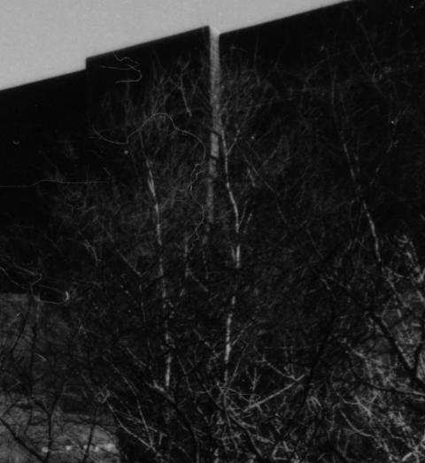

As a LF newbie I've been burning film to get some practice and experience, it made sense to use a lower price film. However I've noticed that the Classic Pan 200 I've been using seems to be soft. I tried a side by side comparison between cp200 and hp5+ and there is a noticable difference between the 2 negs and contact prints I've made.
This also seems to be more noticable about 1/4 of the way in from one side.
Please take a look at the attached scans to see an example. I haven't applied any sharpening, so they aren't quite as sharp as the prints, but they do show what I'm seeing.
1. A section from the LHS about 1/4 of the way in showing the effect I'm seeing.
2. The equivalent section from the HP5 negative
3. A section from the RHS showing the effect I'm seeing but to a lesser degree.
4. The equivalent section from the HP5 negative.

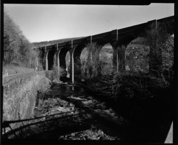

5. The whole scene
The 2 exposures whre made within minutes of each other and used the same aperture, I only adjusted the shutter. Both were souped in Rodinal.
Any ideas? do I have a bad batch? is this typical of the results I could expect from CP200?

The only things I can think of is that the HP5 shot was taken first and the insertion and removal of the film holder may have moved the camera movements/focus or there is camera shake from wind or not letting the camera and tripod settle down after pulling the darkslide. I've not had a soft image from classic pan that was due to the film.

The CP200 was exposed first. I've been seeing similer effects with other sheets of Classic Pan, which is why I did the side by side in the first place. While the CP was exposed at 1/30, I was carefull to avoid vibration so I don't believe that is an issue.

Classic might be grainier than other films and it might also not achieve it´s rating fully (just like most films) but it for sure cannot be less sharp than another film in the way your pictures show it.
I have no clue what went wrong here but my fist impression would be that the image was out of focus for some reason.
I am using Classic and other films in 4x5" on a regular basis and never had images that much out of focus.
