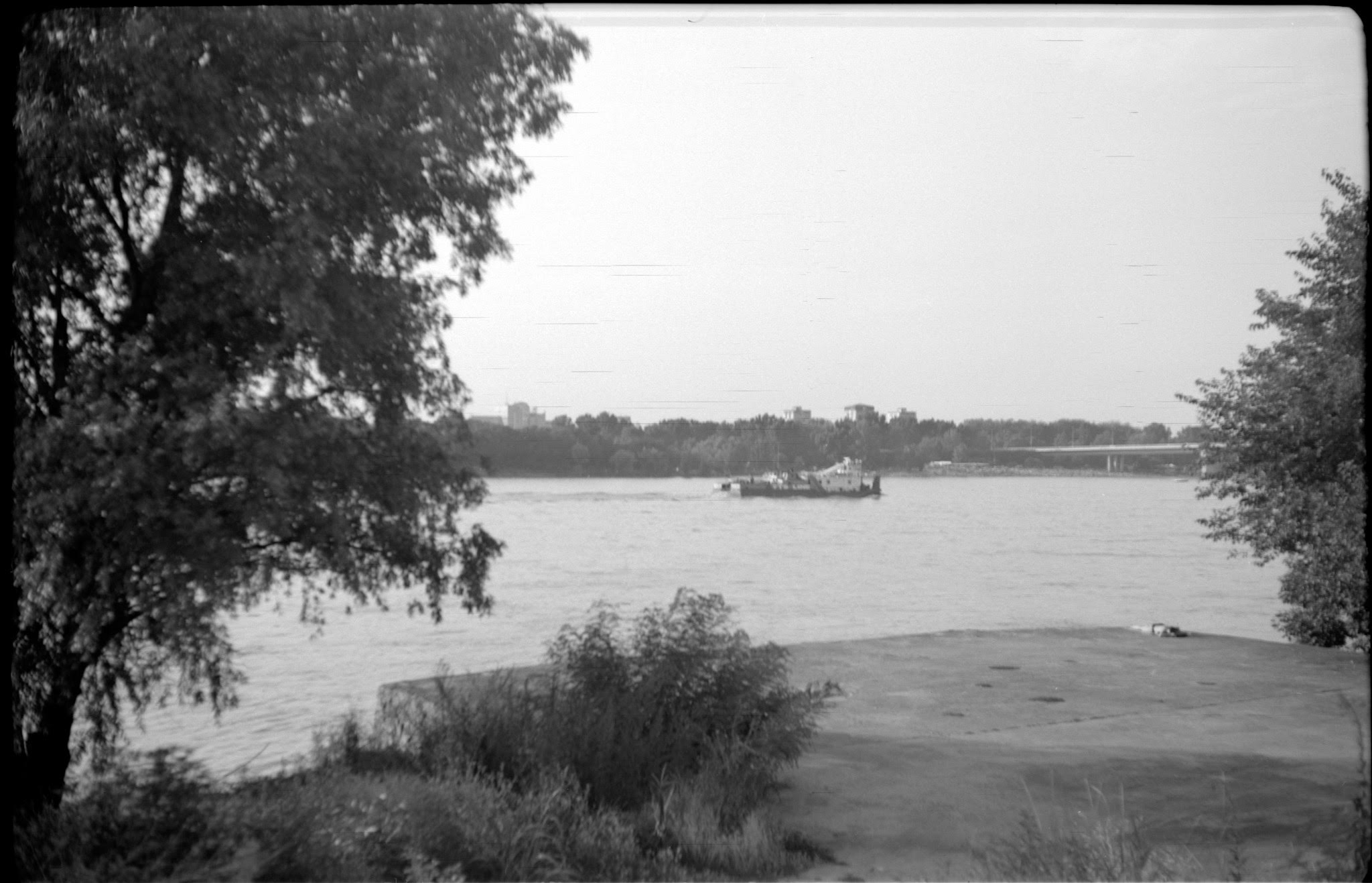

Hi, I got me a Rodenstock Clarovid II last week, and the test roll made me scratch my head. That wasn't the only thing to get scratched, though. Nearly every frame out of eight (with the exception of two) has multiple scratches. The scratches themselves are rather conspicuous on the scan; the other photograph features those metal bits that hold the rolls in place. They have sharp edges, so they'd be the obvious culprits, only I cannot for the life of me fathom just where they'd get in contact with the surface of the film rather than the backing paper.
Another issue is the horizontal stripe at the very top of the picture. I have one on every single frame. Croppable, but irritating.
Lastly, all the focus-to-infinity photographs look somewhat softish. I wonder whether that's a feature of the lens or the result of the assembly being in need of calibration.
I love the look and the feel and the fact that it has a rangefinder, which is a rare thing to find on a camera from the 30s, but it looks like I'm in for some work on this one. Any suggestions on how to solve any of the problems outlined above would be highly appreciated. So far, I'm musing on whether I should just tear out those metal bits and see what happens next…

Could you tell us the film you used?

Then I was on a wrong track...
Well, back to your camera. Have you checked the rollers on smoothness and friction? Keep in mind there is less force by the film to make them turn, than you will apply by your thumb in testing them on friction. (They look fine though concerning their surface.)
Might the film roll over the vertical black edges oft the film gate instead of only over the rollers?
Have you stretched the film excessively after taking it out before sealing it again?

The rollers feel smooth, they were the first thing I checked. Those roll holders look longer than in any of the other folders I have (Bessa I, Nettar 515, Super Ikonta 530, and Rheinmetall Weltax), and they have really sharp edges. I should have checked the backing paper before discarding it, I guess.
As for the film gate edges—that area would have been completely unexposed in the scenario you’re describing, wouldn’t it? Here it’s just a band that’s slightly darker than the rest of the picture.
And, no, I did not treat this roll any differently from the others in terms of applied pressure or anything else.

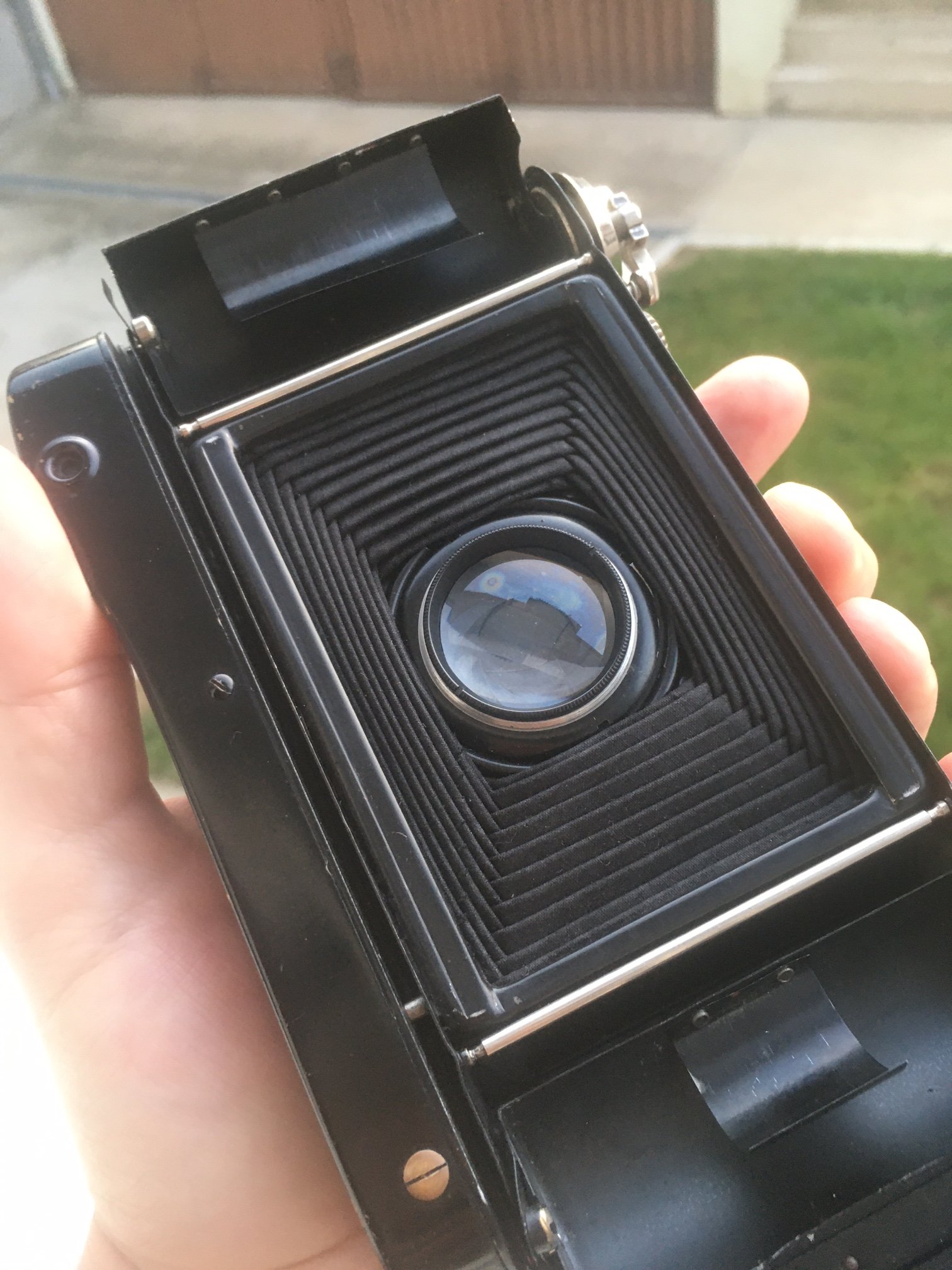

The rear element of your camera appears to have some sort of haze or even a small spot of fungus. If you feel comfortable removing it, you could clean it in an equal mix of household ammonia and hydrogen peroxide. This often clears up haze and fungus. Clean the element with normal lens cleaning solution after using the mixture...

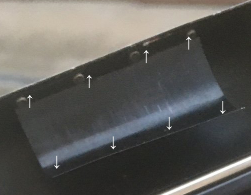

Post pictures of the negatives.
That line at the top of the photo is from the scanner you used to scan the negatives with. It may need internal cleaning of the bed glass and or the mirrors and lens to correct. Clean the bed glass and calibration area first.
The transport rollers at each edge of the image gate appear to be equally spaced on the image frame. They should turn with the weight of a 1mm x 1mm down feather applied to them and have no flat spots.
The tension spring on the supply side should have smooth edges along the width of the film roll, be totally straight, and just touch the backing paper of a fresh roll of film. It appears to be in more on the bottom half than on the top.
Uh, sorry, that's not the case, although I see where you're coming from. That's the way the light hits it. The lens is clean as a whistle.
In the meantime, the dark band mystery has been solved: a microscopic horizontal tear (or, rather, a frayed piece) in the bellows, really close to the place where they're glued to the back of the film gate. Nothing a little acrylic paint won't fix; it's so tiny I didn't notice it until someone suggested it to me. The focus issue is an adjustment issue; I'll have to ask a specialist. The scratches still puzzle me, though. Need more testing.
Good on the clarity of the lens! Better to not have that problem in addition...

and they should turn silky smooth with 0 side to side play and no more than .026 mm up/down of the image frame movement.
I have a Grafex Graphic RFH with pin rollers that scratched film. The lead side pin roller had just detectable roughness/side play, removing it cured the problem.
Use a digital caliper example: https://www.ebay.com/itm/3924964506...c64DSHSVWG2TW3ei6KRj|ampid:PL_CLK|clp:2334524
to measure the distance between the arrows and roller play.
