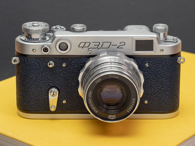

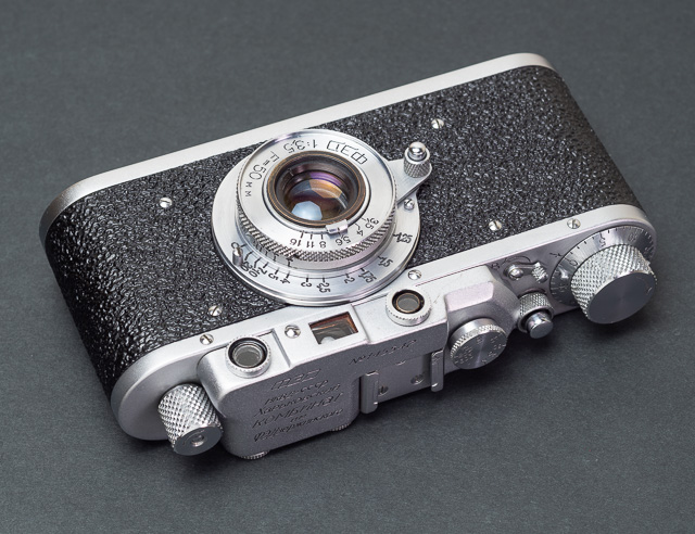

Thank you so much for sharing! I will try some of the cleaning myself. I appreciate all of the wonderful suggestions. This is a super group!!

Exterior finish restoration is kind of it's own specialty, but cleaning, polishing and replacing the leather is something you can probably do yourself. Some of my most-used tools and supplies include:
  • Old toothbrushes (great for general camera cleaning)
  • Naptha aka cigarette lighter fluid, for removing accumulated grime. A few drops on aforementioned toothbrush can do wonders
  • Disposable wooden chopsticks sharpened to a point, for reaching crud in engraved knobs
  • Never-Dull or similar polish/cotton wadding, for making spun aluminum surfaces shine
Here's some examples of what I've accomplished to date for my own personal enjoyment. In these instances, simply touching up the original paint wasn't an option, as it was either heavily worn, or was flaking off the metal surface.
View attachment 301413 View attachment 301414
Most paint specialists seem to cater to the Leica crowd (gee, I wonder why?) but perhaps they could handle a Rollei TLR. I haven't tried the following, but they may be worth a closer look:
https://www.cameraworks-uk.com/re-paint-process
http://www.kantocamera.com/english/repair/custom.html
