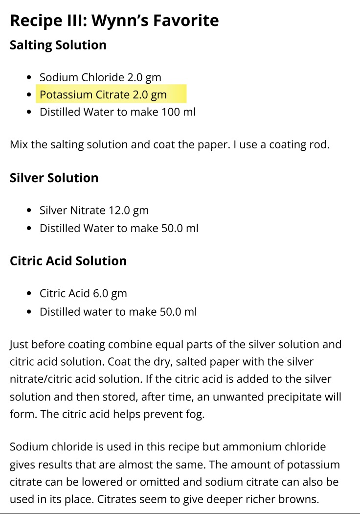

Probably very little difference. Wynn White has suggested KCit.
Right. That's what led me to ask the question. Citrates are mentioned as an aside in Young's and Anderson's manuals. Both advise adding 20gm/L. I'm adding the citric acid to the salting solution rather than the silver sensitizer. I've got sodium citrate, so I'll try that before ordering potassium citrate.
