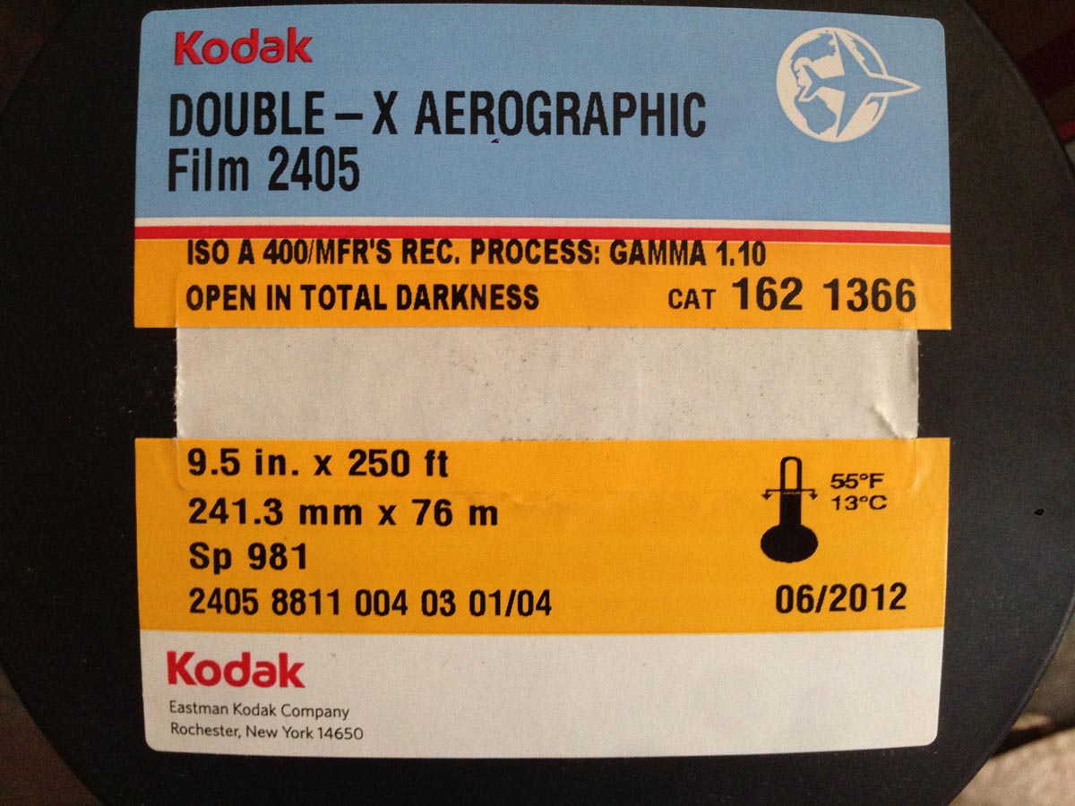

I'm still working on getting a Cirkut #10 but in the meantime I've been gathering film. The usual smattering of expired but (supposedly) well kept actual Cirkut film, that I hope test out OK, etc. But this is my latest score and I have high hopes for it:
Anyone else shot this?

It's a good find. I haven't used it but have used other aero film in cirkuts and al vistas with good success. Some of the aero film doesn't have a anti halation backing and does tend to flare a bit in the highlights. Curious how it works for you when you use it

9.5in is pretty huge, how big is a cirkut?
I use a fair bit of 2405 in 70mm. It's a lot like SFX200 both in its graininess and extended-red sensitivity.
Yes, 9.5in is not really quite big enough, for a Cirkut #10, which originally used 10 inch film. But close enough, given the lack of alternatives.
How have you found the halation to be with the 70mm version?

9.5 inch is fine in a #10 cirkut. The 10 was designed to use any film between 6" and 10", and a lot of people used 8" B&W film in a 10 cirkut when they stopped spooling 10" B&W film, or when they didn't need a 10" wide neg. You just cut the spools to fit the film. I make a jig to cut spools and glue them so they are all consistent.

Different aero films had different halation coating on them. You just have to see for the film type. Plus x 2402 has very little, as far as I can tell, but 3404 has it.
