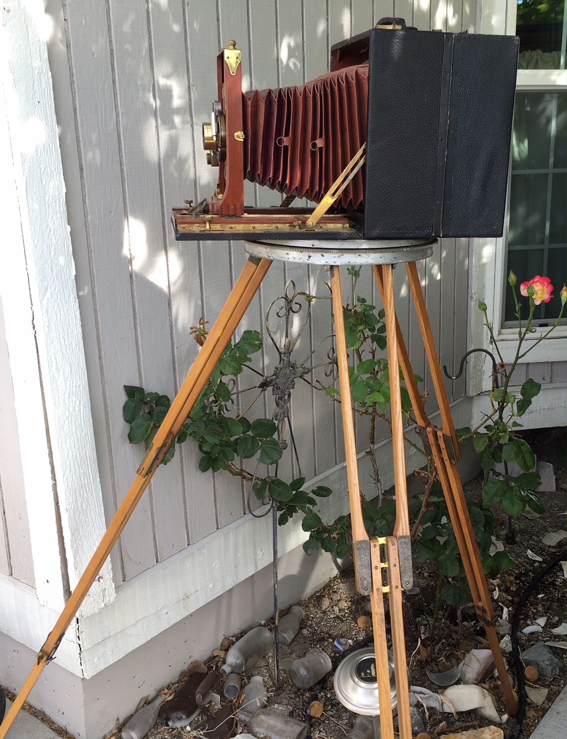

This time the No. 6 Cirkut Outfit with 6 1/2" spool (largest possible in that camera)
Very imperfect and when you click to make it big, they will be readily apparent. The wind was blowing gusts up to 50mph, but the day was so visually compelling I did the best I could with it. This was with a 13 3/4" B&L Protar VII. The negative is robust. If only . . .

This camera is now posted for sale on ebay if someone wants one of these outfits. Sadly, ALL of my pictures normally posted here have gone missing as the folks who I've paid for 20 years to host my pages have vanished. I haven't been able to communicate with them. No one answers the phone. I fear 20 years of effort, and a valuable resource may be lost. If by chance you want this cirkut outfit, contact me here. You'll have to look at the images there though.
