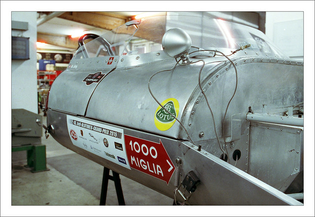

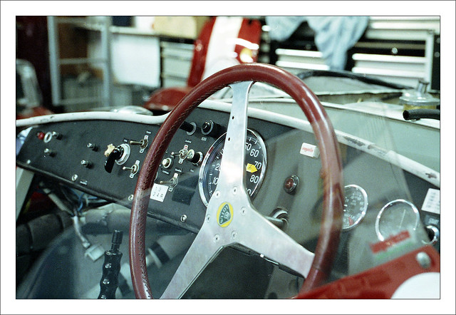

Wow...those look Fabulous.!
That last frame, is that a real Ken Tyrrell F1 car.?
macfred
Nov 6, 2014
3,839
Germany
I really don't know ... :redface:
The story behind :
I'm not familiar with cars and I never did a driving license ... I usually go by bicycle or bus.
It was a boring sunday afternoon when my brother-in-law (a car enthusiast) persuaded me to see the garage, where he often hangs around http://britec-motorsports.com/
I shot a few rolls with my F4 - that's what I got.
Another legendary (my bro-in-law said so ...) race car from the garage :

Its just not fair.....not fair at all, I tell you. :smile:
Yes, one might say it was legendary. :smile:
Anyway.....those came out Great IMHO.
Thank You for participating.
I Appreciate It
