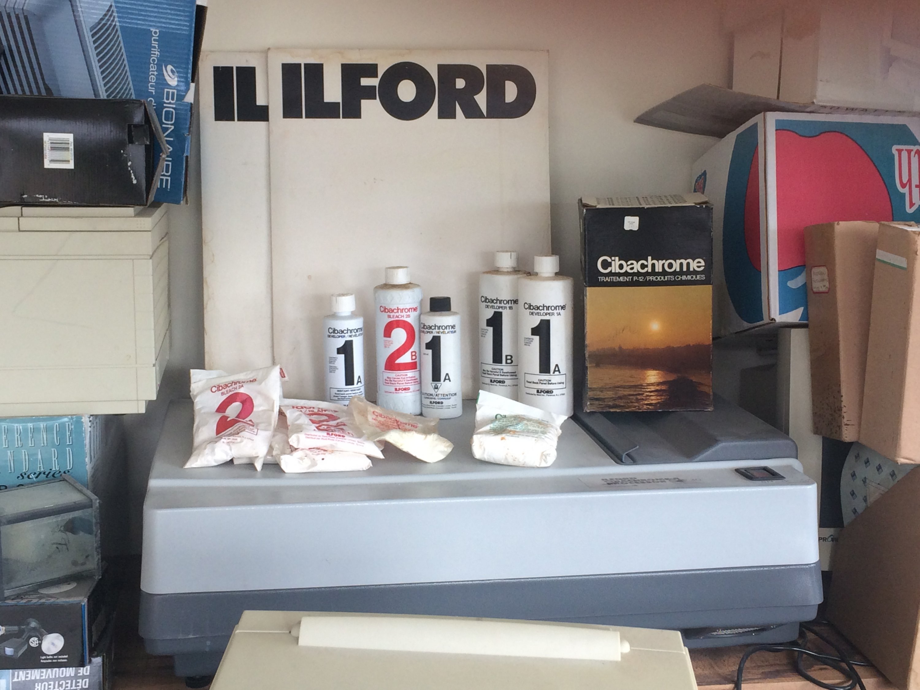

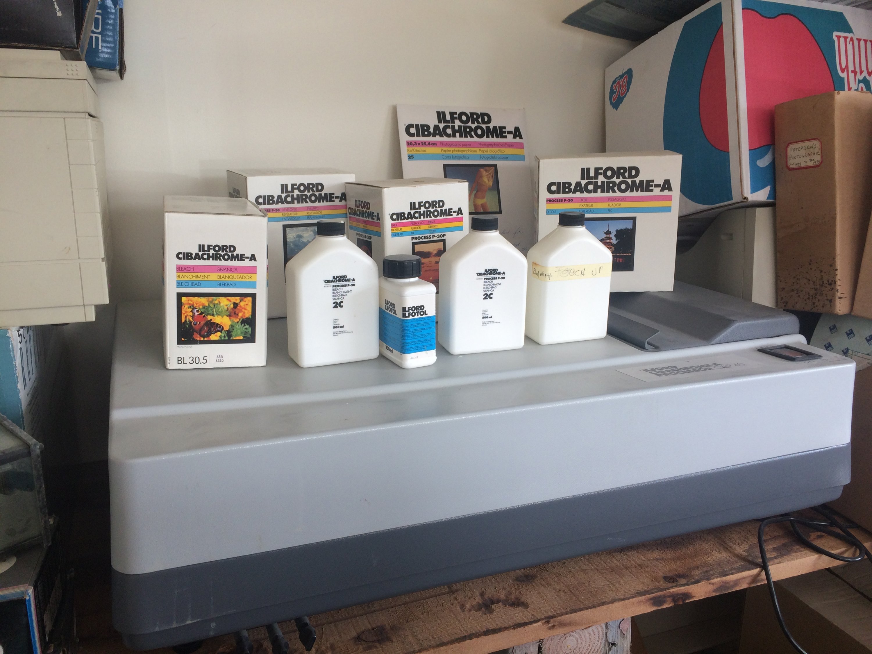

I have discovered a hoard of darkroom stuff and am looking to sell for a good price. It includes a Cibachrome -A processor as shown, model CAP 40, and literature on its use, magazines on Cibachrome processing, 2 16"x20" Cibachrome paper, one unopened 8"x10" Cibachrome paper package, lots of Cibachrome chemicals & 7 packages of Cibachrome bleach.
Although these are over 20 years old and have not been kept in temperature controlled environment, they might still be of use to someone who loves Cibachrome, and I would appreciate hearing from exp erts who could tell me if this stuff still has value. IMG_0918.JPG IMG_0941.JPG IMG_0948.JPG IMG_0917.JPG

Oh man I wish I was local, there are parts available to re-gear these to make them usable for b&w and RA4 work. There have been some on eBay and local craigslist and they have always sold quickly, shipping is an issue though because it's so heavy.

The processor could probably be repurposed for RA4. The paper itself is probably useless. But the mylar sheeting itself makes excellent cutout mask material, or could be fixed out and repurposed for a coating base of some alt process perhaps. The P30 bleach powder is probably still good, while fixer and developer could be improvised. Finding paper that's still usable is a long shot.

Or just look for an ICP-42 or Thermaphot equivalent (they made them all) which comes ready for RA-4. They are a little harder to come by. The CAP machines come up several times a year on ebay.
I'm pretty sure the bleach formulation changed several times over the years, but I don't know if that affected one's ability to use it on paper from different eras. Point being, would the most recent paper even work at the highest quality level with such ancient bleach? Maybe, I dunno. I started Ilfochrome in 1996 and those kits appear to predate that.

The amateur P30 bleach used powder sulfamic acid. The pro P3 was primarily composed of liquid sulfuric acid, so had stricter shipping regulations. There was also a P3X made for faster high temp processing. Roller-transport processors had to be specially made of much more corrosion-resistant components than RA4 processors. Plastic processing drums aren't affected by acid, so almost any of them will work. The developer was changed when self-masking Ciba was introduced way back in the 70's, but the bleach kits remained the same.
