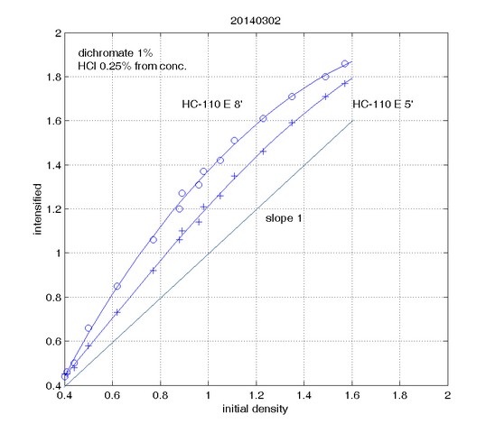

Context: doing tests since 2 months to qualify chromium intensification before using it on actual film that need it. The film I need to intensify is Fuji Neopan 400 120. Developed as per Fuji's datasheet, D-76 1+1 9'30" @20°C. Contrast too low for comfortable printing; can't give value because I phtographed scenes, not gray scales. Test are made with Fuji Neopan 400 135, same devt. Contrast (well, slope, do NOT want to argue about the relative merits of the various definitions) is ~0.45. After some initial trouble from using "household" quality HCl, I have decent intensification. Concentrations in working solution: 1% dichromate and 0.25% HCl (from maximum strength HCl 37% w/w). Re-development in HC-110 dil.E; also tried FX-37 (similar result), Rodinal, Dektol 1+3. BUT, when plotting D(after) versus D(before), the slope, initially >1 (intensification!) tapers off. Process can't boost high densities (in relative value) as well as low densities.
Question 1. Anyone here has personal experience with chromium intensification? Pre-soak time? Time in intensifier: just the time to bleach, or twice that, or what? Agitation? Wash time after bleach? Developer; which? Use normal time for that film, or develop to "gamma-infinity" (how long?). Any sensitometry like I show?
I have the impression that the problem does not lie in the re-development but in sub-proportional deposition of chromium. To prove it, I should measure densities before re-development. TBC.
Question 2. More out of curiosity, a question to qualified chemists, a few of which seem to be around. The oxidizer is Cr+6/Cr+3, that has a potential larger than Ag+/Ag. So, in the presence of Cl- ions, we have re-halogenation. But, how does the chromium get to Cr0, supposedly the cause of intensification? The potential of Cr+3/Cr0 is less than Ag+/Ag. And, (related to first question) what would influence how many chromium moles end up as Cr0 per mole undergoing Cr+6->Cr+3?

Doremus, Gerald,
Thank you for your input. So, the "chromium compound" shall remain a mystery of photgraphic chemistry. As for staining developer, I had that on my list in case regular chromium + developer does not meet my goals. But I had in mind rather Pyrocat HD, and still bleaching in dichromate. According to some accounts (tbc) Pyrocat HD has a less pronounced compensating behavior than PMK. But since I have no personal experience I'm not going to argue on their relative merits. When I'm through, I'll post an account of the results.
