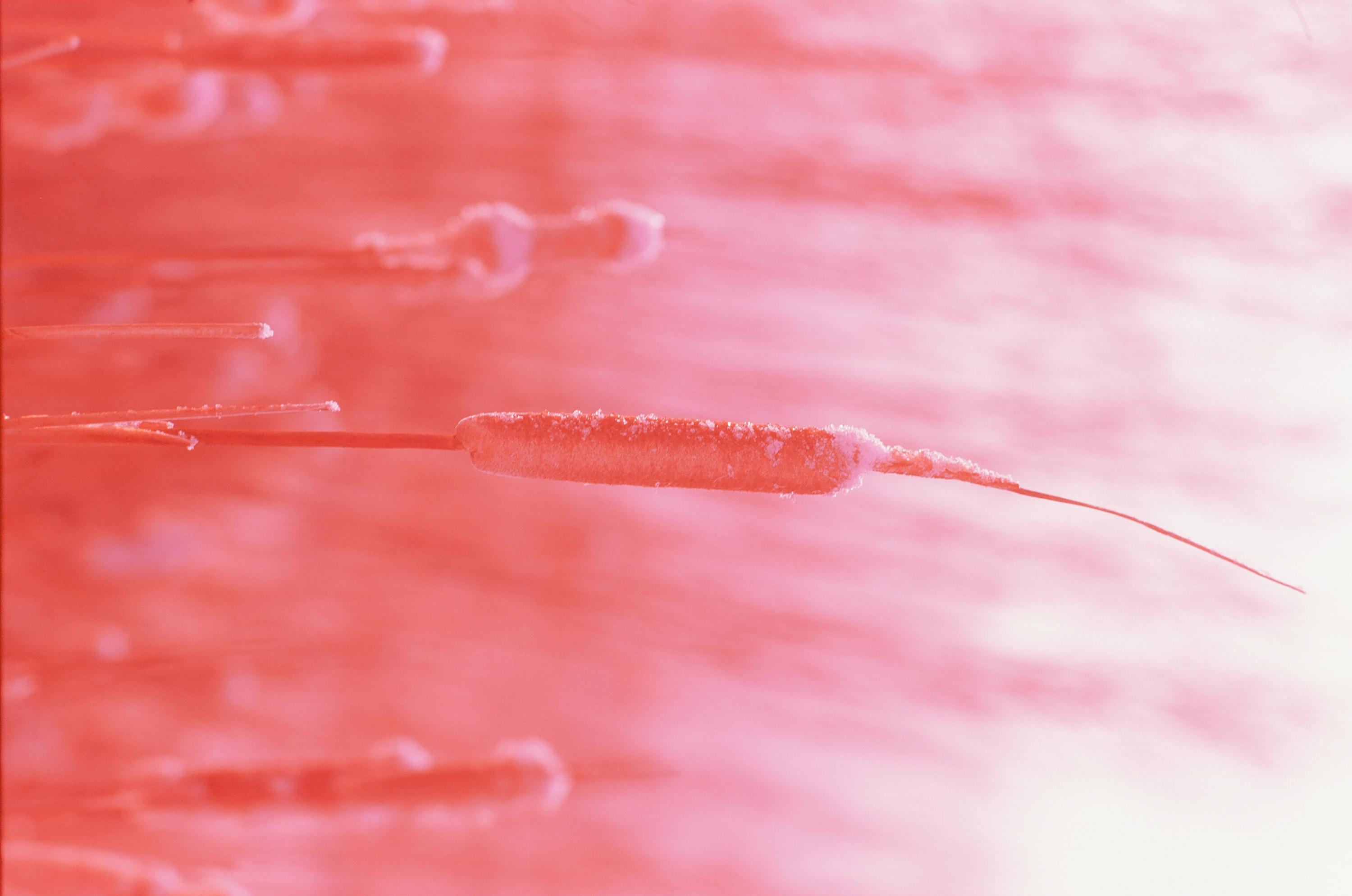

So,,, if a lab soups a roll of transparency film,,, fugichrome or ektachrome as a negative,,, what do the colors look like? Pink/Red monochrome?

Basically the film will look like a C-41 maskless negative. Due to the cross-processing the hues will be off a bit and the overall contrast will be higher.
(On the assumption that it would be processed in the C-41 process.)

I happened to me once, after a long strenuous mountain trip. The Ektachrome got put thru C41 by mistake. The shots came out with much longer range (not higher contrast) than a proper chrome, much like a color negative, but were impossible to color balance correctly on RA4 paper, and looked more weird than interesting. I wasn't amused.

Humm,,,I've been known to send found rolls in for processing after a period of time,,,but nothing this bad.
This is called cross-processing and it sometimes is done on purpose. Some films produce interesting colour shifts. Old Ektachrome emulsions (EPP for example) gave a greenish/yellowish cast with high contrast and nice rendition of reds...

thse thread might be of interest to you ... ( not all e6 some c41 in there too )
i have some photos in my "albums" that are c41 + e6 cross processed in caffenol 130
the chrome film has a yellowish cast to it the c41 has an bluish cast to it
they kind of look "different" when you electrify them ...
i haven't processed a lot of color in b/w lately but the fall is around the corner ...
the grain is really smooth when you cross color and b/w .. im not sure what sort of b/w emulsion
they first coat these films with, but it is nice, almost too non-grainy for me :wink:

E6 in C41 gives you varying results from manufacturer to manufacturer and from film to film. Due to the extra layers to compensate for fluorescent lighting, I have been told (and have seen) that Fuji, cross processed, gives more trouble in printing. I have found myself that Kodak EPP cross processed the best. It almost prints like a color negative.
