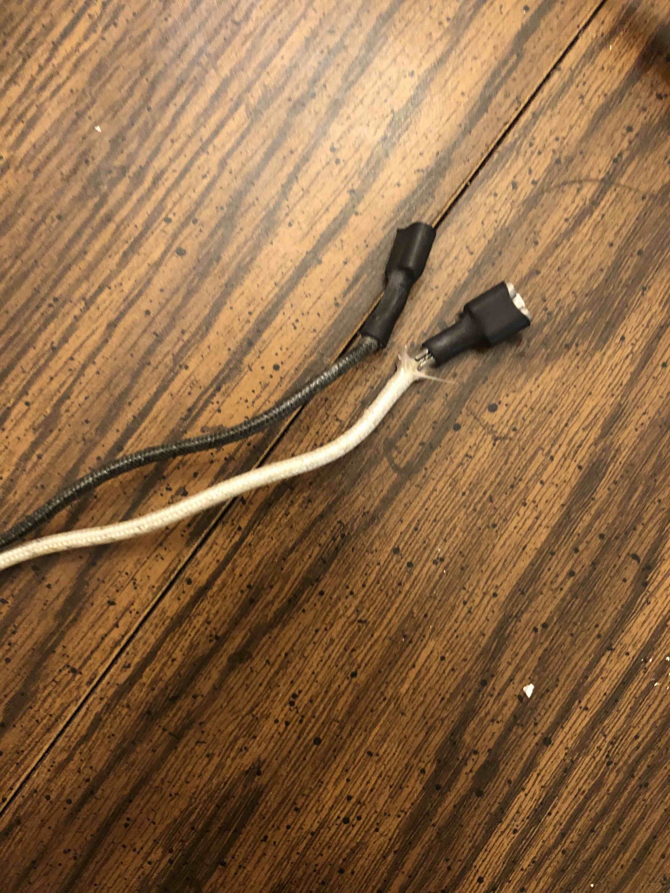

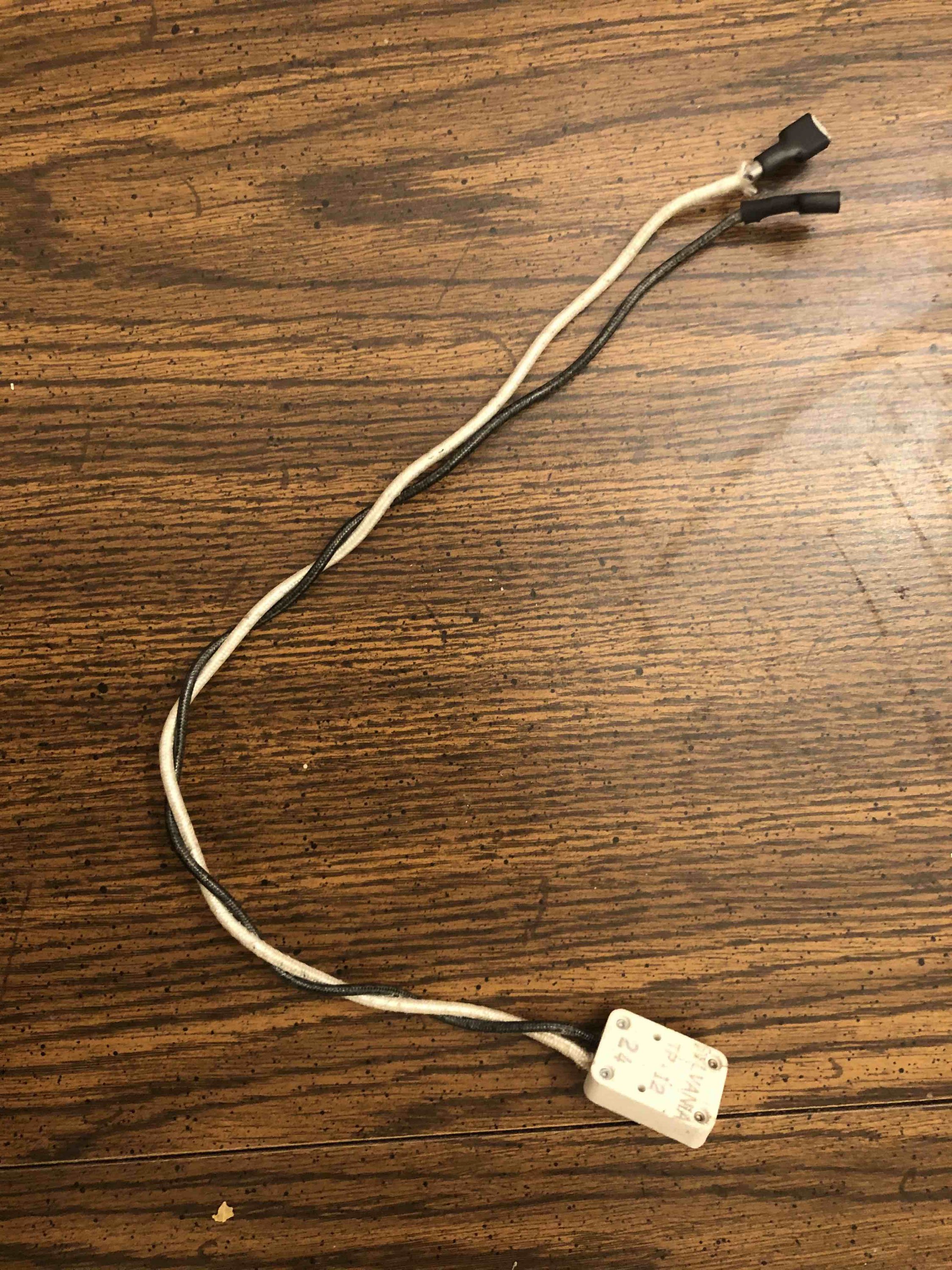

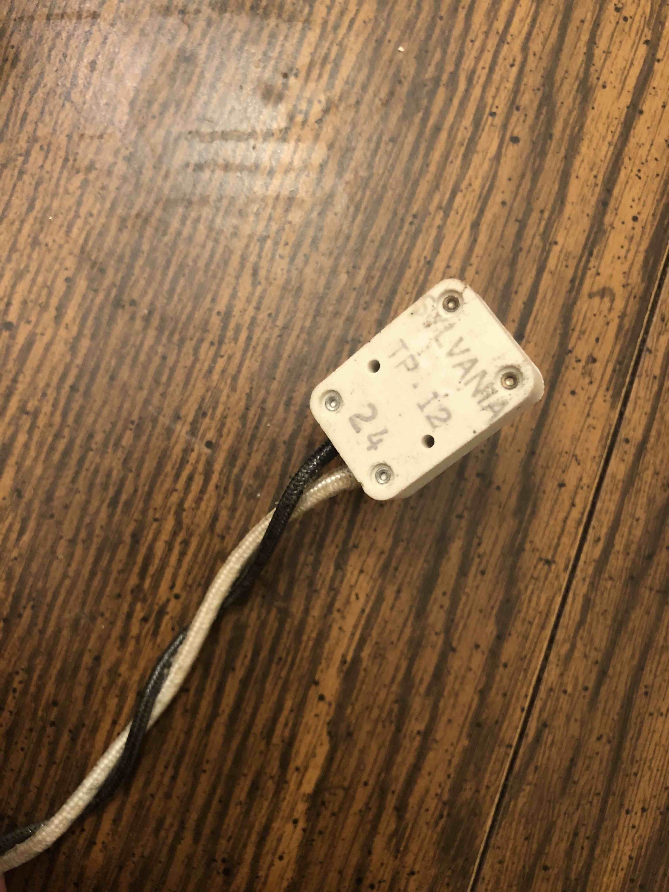

I don't have a replacement on hand, but on that suggestion I opened up the enlarger head to get a look at the lamp connections themselves. It looks like across the two pins the lap socket connects to there's a constant 25.11 volts or so AC, which would indicate to me that it was indeed the socket (as the lamp is 24v). However, when I bridge those two pins with a spare bulb to confirm that the socket is the issue, the lamp won't light. Is there any squaring those two results?
The bulbs are both old stock Omega 471-029 rated for 22.5V. I've attached pictures of the cables, but they appear to be in good shape for the age. They're flexible, but they have acquired a memory over the years, if that makes sense.

A single strand of wire will show community and voltage but it will not carry the current load.

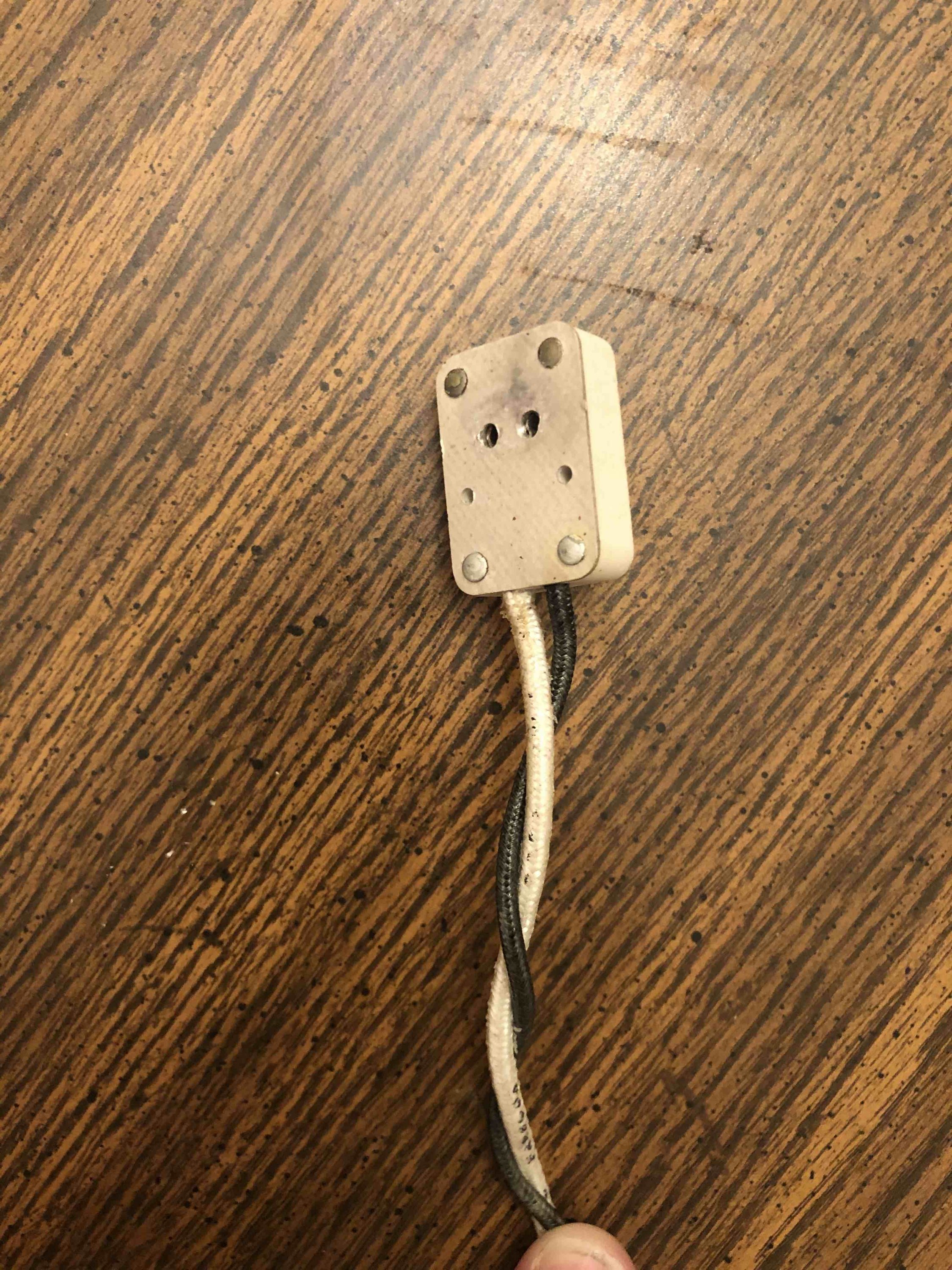

The wires at the connectors, especially the black, look weak. The black looks burned. The socket has discoloration at the black wire contact.
1. repair or replace the socket and wires at the connectors.

Heat from the bulb will eventually weaken the metal in the socket contacts resulting in them not conducting current even if making solid contact. The indication of this is that the bulb burns out quickly.

  • I replaced the enlarger bulb socket with a modern shielded replacement, and, which should hopefully improve longevity (though if this one lasted forty years I don't know how much of a concern that was in the first place). I'm now getting 25.11 volts AC to the socket, which is good, and should be sufficient to power the bulb.
The one issue I still have is that neither of my bulbs work despite having solid filaments, but I think that's the result of a bulb-side variation of the issue shuttlefinger discussed in his P.S., as there's some charring on the leads. I've ordered a replacement bulb, and unless something deeply weird is wrong I should have a working enlarger once it gets here. Once I confirm that I'll update this post with my results and some documentation on the timer bypass, which should hopefully help save a few of these from the trash. It's a $5 no-solder solution, thankfully, so it's very easy to implement.
