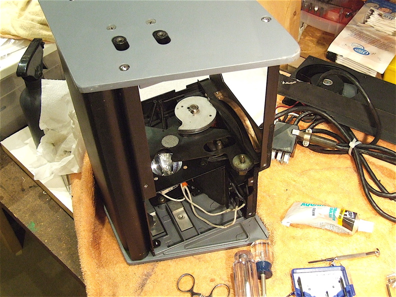

I refurbished a "D" Chromega for a friend about 15 years ago. It looks like it will last a lifetime.
