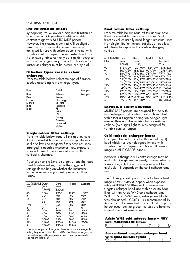

I dug up my old Chromega D4 again because I had a series of rather 'harsh' negatives that perhaps would be better printed on a diffuser head enlarger.
But I never printed FOMABROM FB III with it, only AGFA, and I know that the dial in filters concur with the KODAK colour printing filters from that time.
The tech. data from FOMA only speaks about the DURST values for a colour enlarger and ILFORD Multigrade filters for B&W, but no KODAK information.
I would like to know how to convey KODAK <—> ILFORD filter values.
So, I can make a chart with the contrast values in ½ steps as a starting point, and variate afterwards.

This page from the Ilford publication "Contrast Control for Ilford Multigrade pdf - which can be found here - https://www.ilfordphoto.com/amfile/file/download/file/1824/product/2019/- may supply you with your "Rosetta Stone"
Thank you very much Matt!
That's what I need, it didn't occur to me to look into the ILFORD documentation to find info that could apply for FOMA...
But thank you again!
I think I will use the dual filtration, as I did at the time with the AGFA paper.
The Chromaga I have is the old one, the so called "Mikey Mouse", using these impossible to find longish bayonet bulbs at 20V in pair.
I still have a few in spare, but when one dies I have to change both to be sure that the lightening will be evenly as these bulbs are blackening with age.
But I keep the still 'good' one, so I have two 'old' bulbs when the the other one dies too...
