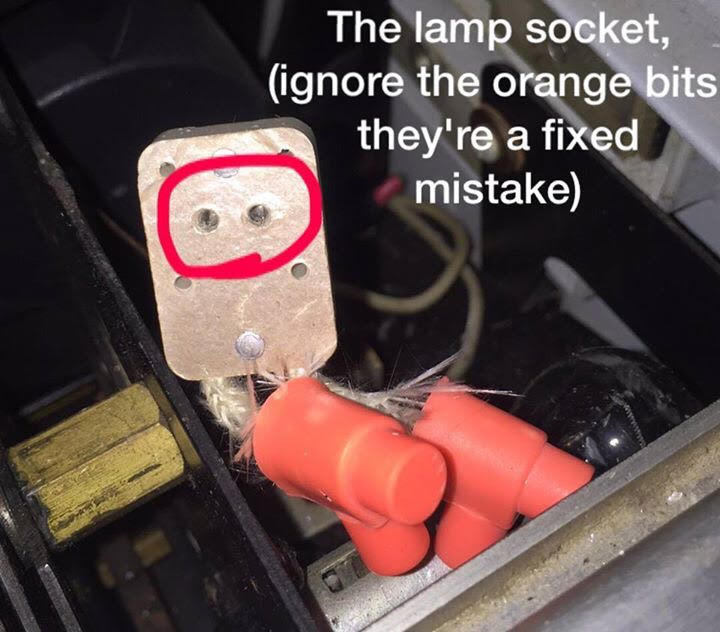

It is a brand new lamp confirmed working, yet it doesn't power on, and neither does the illuminating lamp for the front panel. These are both confirmed working.

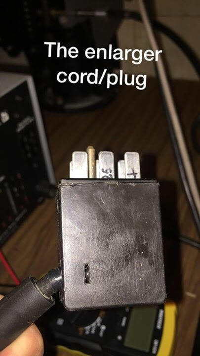

There are no breaks in the cables between the enlarger cord/plug and the lamp sockets.
I'm thinking either when the person before me rewired the fan, they may have connected the lamp back to the wrong pin. Mine is on the middle two.
The lamp socket, although doesn't look the best, works fine and the connections are a-okay.

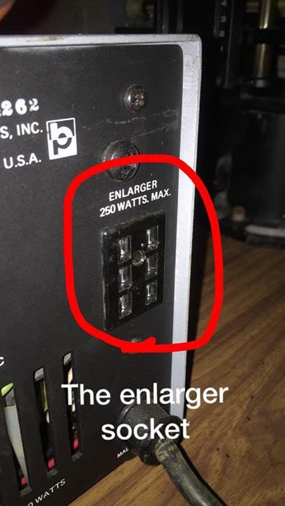

The enlarger socket outputs 250vac on the top two sockets, both when the exposure switch is powered on and off. 50vac on the middle two when off, and 98vac while on. The bottom two output 3vac when off, and 5vac when on.
The lamp sockets output 22.5vac when the exposure switch is OFF, and 35.5vac when it is ON. Is this normal? I thought it would be 0vac when off and something like 24vac when on?

The main lamp works at 22.5 Volts - 250 Watts (Omega 471-029, originally made by GE), the illumination has 120 V / 6W, and the fan runs with 115 VAC / 9,5 W. If you are not getting these currents (or something close) at your sockets, the wiring is messed up.

for example, you can measure AC between two leads of the transformer, or between one lead of the transformer and the case or some other part of the unit. Results might be different. Do they use three-pronged plugs over there?
