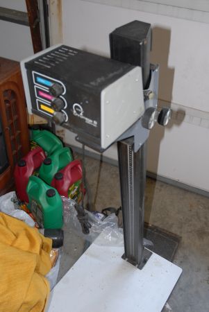

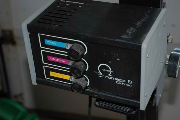

Maybe there's some confusion, here's what I've got, I'm just needing to find a way to power it up. 5Le5N95M13G93ma3N9c6jdb008e7e3db8165a.jpg 5I85Hb5R63E63J33pbc6jbbf93615f0491e6a.jpg

Sorry to rain on your parade, but I think you have a tall, $5 paperweight. :sad:
This is the problem with buying used enlargers. You have to be careful that what you get is complete. You could probably be patient and find another Chromega B for the same or less than you're going to find a good power supply separately.
The other trap is that you get a complete enlarger for say, $25, then you need another lens board and a different neg carrier. All of a sudden your $25 enlarger has cost $100. :blink:
All you have to power on the Chromega B (I have one) is the bulb. Someone handy with electrical stuff could build a power supply given the specs, or even refit the head with a 120V bulb. But, I'd bet you're still going to spend more time and money than just finding a good and complete machine.
Just my opinion - YMMV. :smile:

Keep looking and be patiet. "B" power supplies occasionally are given away for free. Someone has the power supply for your enlarger and is using it as a paper weight. I got a free "D" power supply a while back. The unregulated power supply is just a transformer in a box and there is not much that can go wrong with it.
Also, you can get a generic 75w supply from a number of sources. The pins are slightly differnet on the 120V dichroic lamps, so if you go that route you will need to replace the lamp socket (not a bad idea in any case).

A volt is a volt. It doesn't need to be a specific power supply, just one at the right voltage capapble of supplying enough current.
What is the bulb rated at? If it's 24v 75w, a 24 volt 4 amp power supply would be easy to find.
