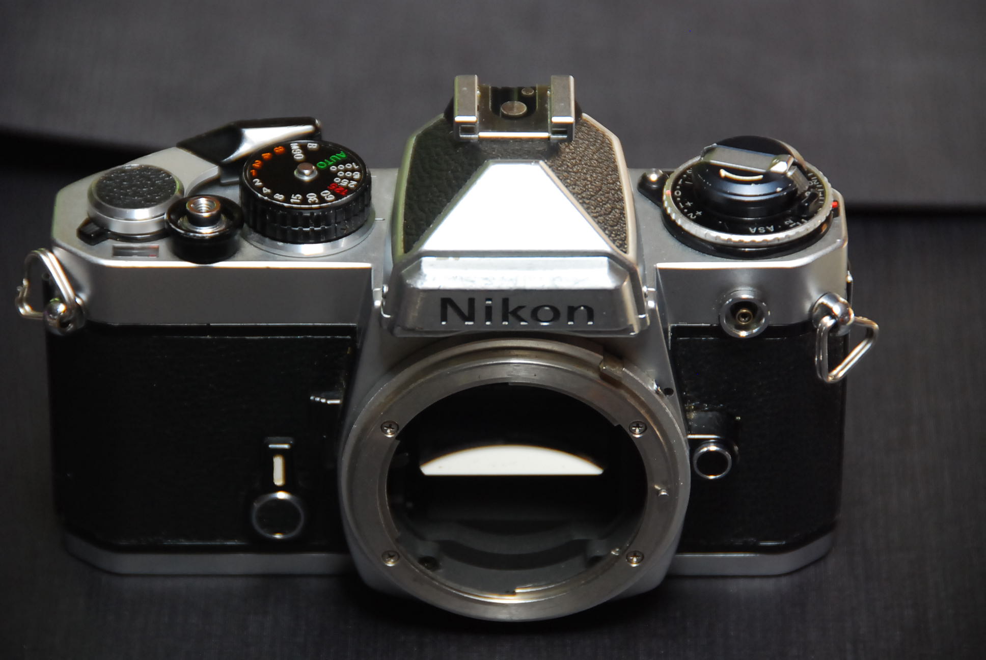

I bought this BGN from keh a bit ago. Worked fine...until a few days ago, when:
1) the mirror stopped returning down...it just sticks open now, and I have to take the lens off and flip the lever to bring it back down
2) perhaps related to the above, the film winder won't move past being turned on; so, to test this mirror issue, I've just reset the shutter from inside, manually moving the winder, as the stroke winder just won't get past 'on'. Included is a 2-month old FE battery...so that's good :smile: Actually, focus, meter, etc., is all functioning as it should...so if you know how to clean up old oil to have the mirror return, then this could be functional again as a whole.
$20 + $3 shipping (first class)
I just posted in another thread about someone else having a camera with a similar problem. Sometimes, all that's needed in a case like this is to replace the mirror bumper foam. If you don't have a foam kit, just cut down a bit of the felt from a spent 35mm film canister to fit, and apply it with some rubber cement or other light adhesive (no super glue). Super easy to do!
