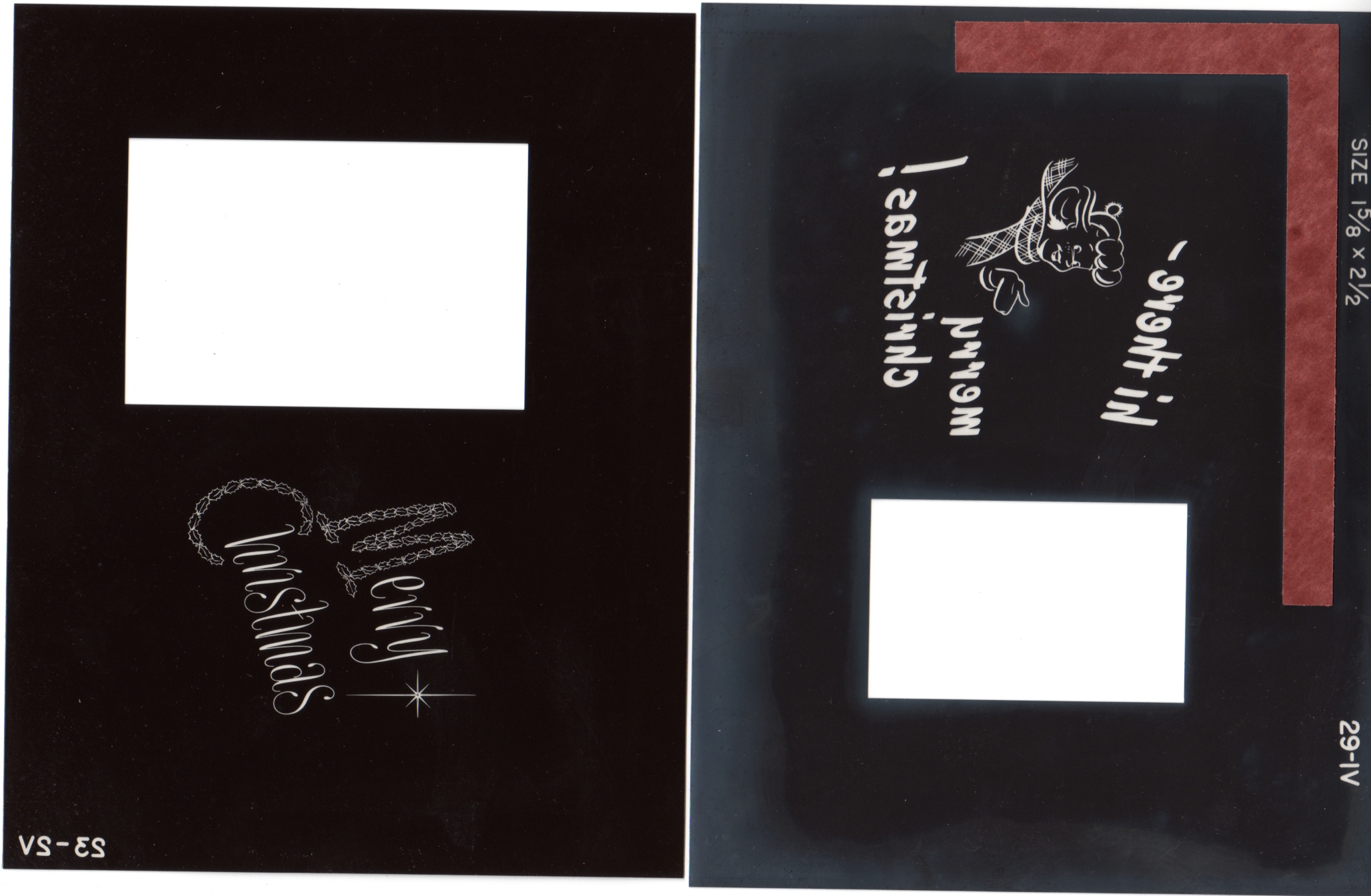

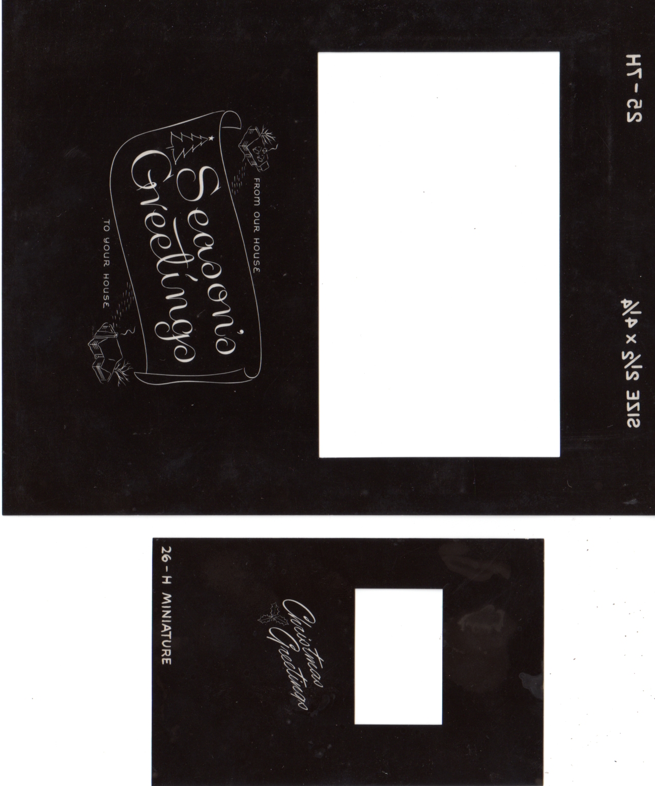

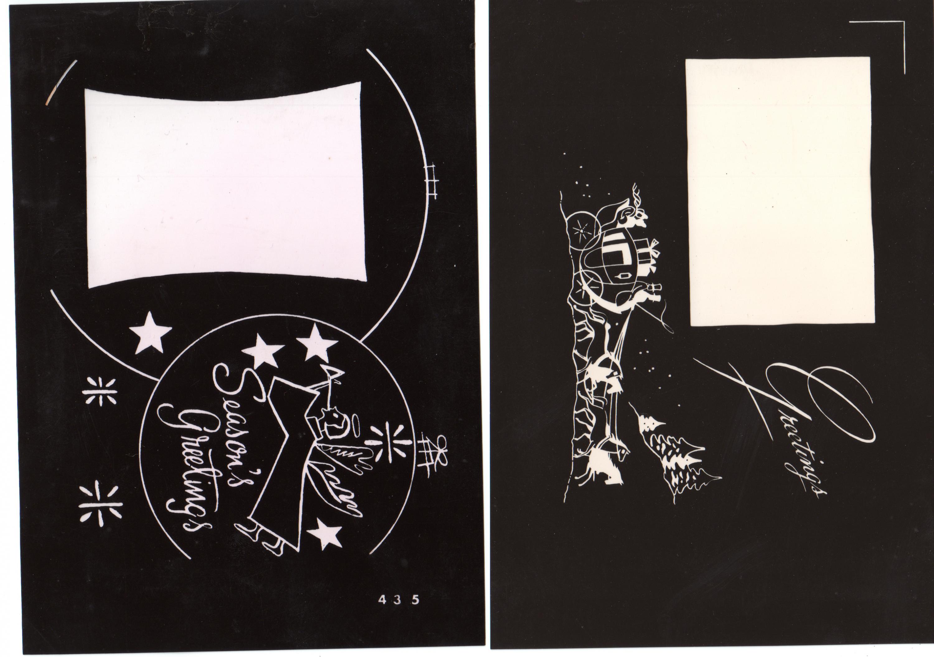

Here's a bit from the past. I picked them up on ebay a while ago. This is a small sample, all different sizes and graphics.
Might be an idea to try.

George-those greeting card masks are awesome-I presume they're for contact prints? And if you're not using them this year I don't suppose you'd be willing to send me one or two to print with? I'll be happy to cover shipping and some extra escrow to make sure you get them back-they look like they'd be perfect!

Ryan! Yes I think they were originally designed for contact printing. The image sizes match most film formats of the time - I'm guessing they date from the forties. They are actually silver film.
I had thought about loaning them out but it's getting a little late this year, maybe next August or September. I've never taken the time to completely sort them out. There are over a hundred all tolded but maybe only twenty or so images each with different image sizes.
