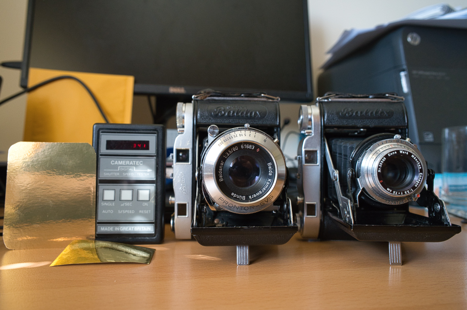

Appologies, I'm a bit late to the 'party' so to speak, however I have a few Balda Super Baldax cameras (currently16 so far). I also have a few Franka Solida cameras, mainly Mkii and Mkiii's). The Balda Super Baldax is the better made camera (in my opinion). I think I have all the lens combinations for the Super Baldax, and even though the Baldanar f3.5 80mm lens is the slowest lens to be fitted to this camera it is capable of taking very nice photos. The Super Baldax is also a little 'quirky' with the way the film wind mechanism works and 'quirky' is half the fun. You only need to use the red window on the first shot, after that if the mechanism is working correctly the rest of the shots will be correctly spaced.
Photo attached of a similar Super Baldax with the Baldanar f3.5 lens and a mess Baldix with uncoupled rangefinder and Ennagon f3.5 lens on the right. A small shutter speed tester is on the left of the picture.
Kind regards
Jeff
