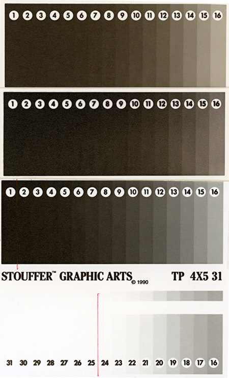

I have seen just about every possible ratio of these two halides in emulsions. Warm tones were generally obtained by using other chemicals in the emulsion or changing the order of addition. For example, Copper salts were used to make warmer toned emulsions.
PE
Also, a ClBr emulsion that is more or less balanced for the two halides is very flexible as far as development color goes. A print can be made in any tone from black to brown. The easiest way to do this is to add KBr to the developer and considerably increase the exposure time. Attached is an image of three prints stacked during scanning. All the same ClBr emulsion, same basic developer, just with varying amounts of added 10% KBr solution and increased exposure time.
I was wondering if the same result could be achieved by a greater excess of bromide in the emulsion ?
And on one hand, bromide in the developer gives warmer tones, but on the other hand, pure bromide emulsions aren't warm toned... is it the presence of chloride that permits a combined action with bromide to yield warm tones ?

If that were so, then the many emulsion makers would not have resorted to all of those exotic chemicals to get the tones as well as a good curve shape.
