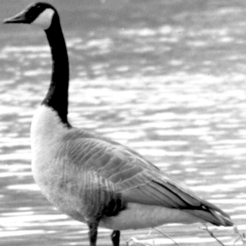

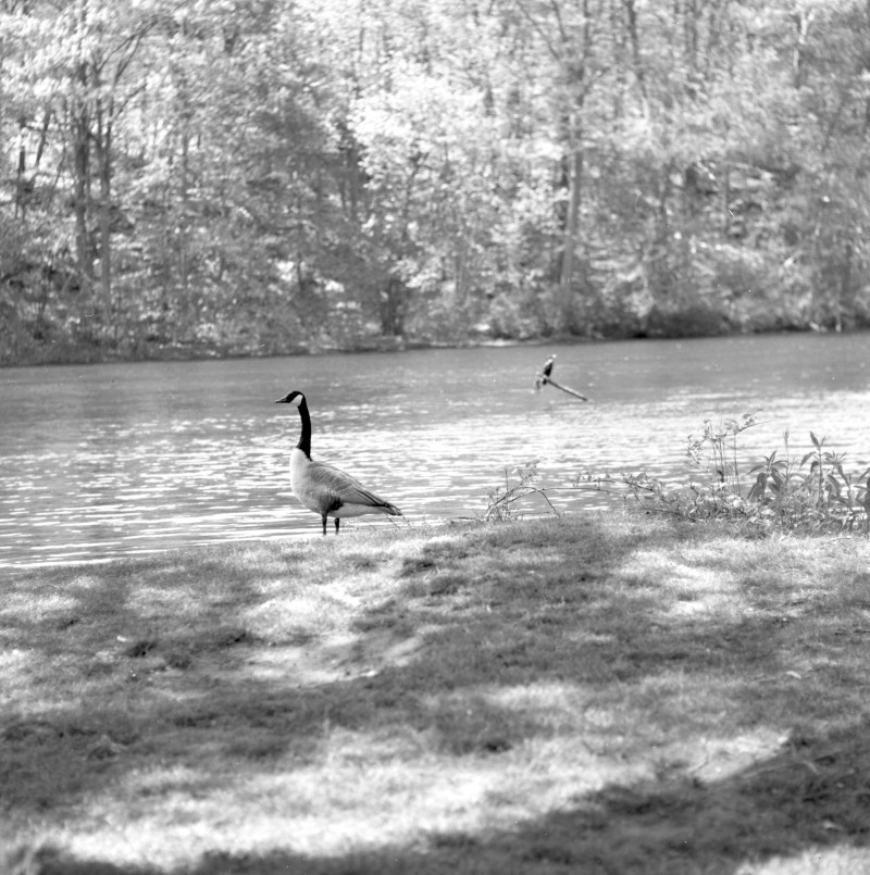

I got an overwhelming urge to try some Shanghai GP3 film a while ago, so I ordered a brick via eBay. I'm attaching scans of one shot from my test roll. One of these is a full-frame scan scaled to 800x800; the other is an 800x800 crop of the scan. (The scan was a direct negative scan at 2400 dpi on an Epson flatbed scanner.) APUG may scale these uploads, too. My notes indicate that I developed in Dead Link Removed 2+1 for 10:00 at 20C, with good density. Physically, the film is extremely curly -- even worse than Foma films in this respect. The emulsion also seems very prone to scratching, so exercise extreme caution when handling it.

Oh, one other comment: When I removed the Shanghai GP3 from the camera, there was no obvious way to seal the roll (no glued paper strip as with other brands). I later found a glued paper strip in the empty film-feed location in the camera, but the glue was so weak it would probably be useless. The fact that it came off the roll as I wound it to the end speaks volumes, I think. So: Be sure to carry some tape or a rubber band or something if you expect to shoot more than one roll of the GP3!

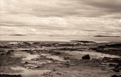

I agree.
Attached is in R09 @1:40
Zorki6/Industar
