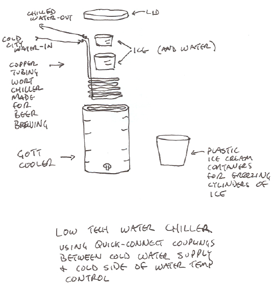

jstraw
Aug 27, 2006
2,699
Topeka, Kans
low tech chiller
I'm a new guy planning a darkroom construction and I'm smiling here seeing that my plan is in no way original.
Here is the sketch I just drew up:
