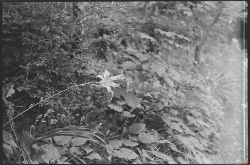

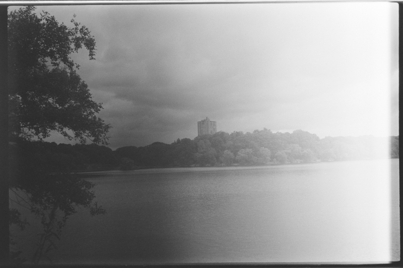

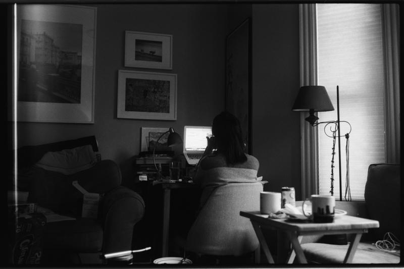

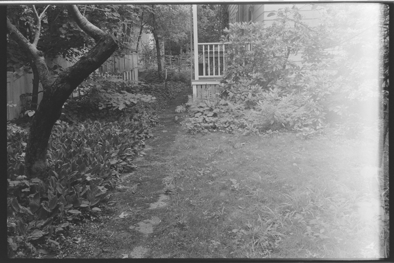

Well, this is my second thread about this camera, after first wondering how to clean the VF. I've shot two rolls with it and there's clearly something up with the shutter - either curtain bounce or something similar. It's inconsistent shot-to-shot and I'm not even sure it always happens at the same speeds (though I didn't have the presence of mind to write down speeds for each shot). Here's what it looks like:

I thought of this, but the extent of "outside the frame" light bleeds is as you see in the 2nd and 3rd shots - just a smidge over the top and bottom edge of the frame. I suppose it could be coming from somewhere within the mount/shutter box?

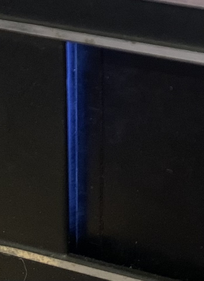

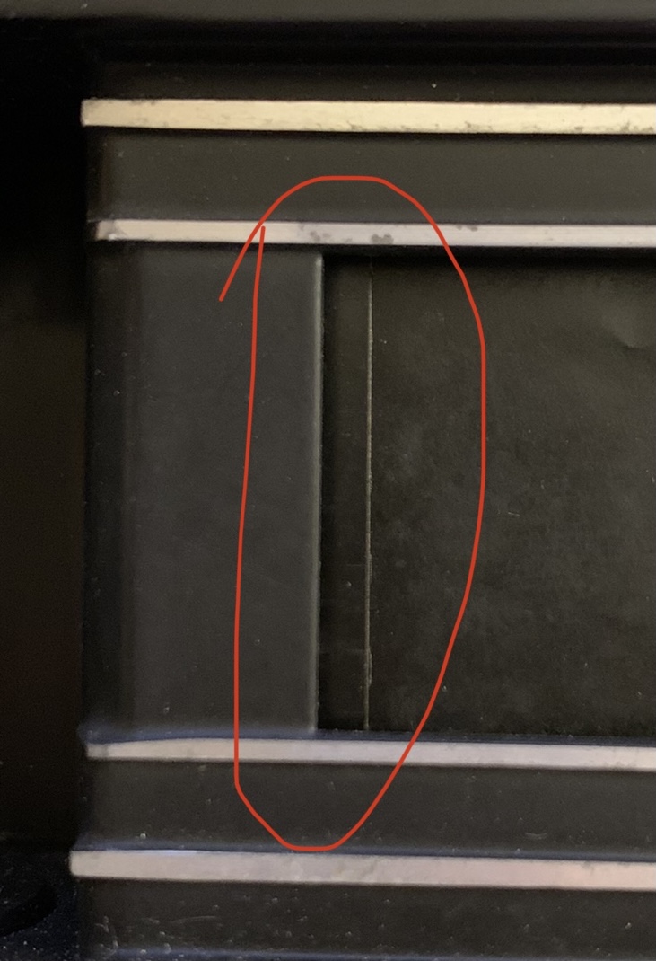

Check and see if the curtains stay together when you are winding the film/shutter. Looks like they don't by the negs. Wind it a little and see if there is any light leaking between them.
The plot thickens! They do overlap when cocking the shutter, but they only start overlapping when the trigger is a click or two into its motion. Dunno why I didn't try shining a light in in this state before, but look at it when the shutter's uncocked!
