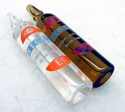

At one time Tetanol used to package developer in small glass veils similar to injectable medications for developing small batches of film as one shot. Are they still available?
Yes, they are. Back in the 50’s and 60’s Tetenal sold Neofin developers in glass ampoules — see photo. You had to snap off the “head” of the glass tube to pour out the concentrate; sealed glass tube = little to no oxidation. My first use back in the late 1990’s was when Neofin Blue, Neofin Red and Neofin Doku were sold in resealable glass bottles; I know that at some point Tetenal sold Neofin in soft plastic bottles, but apparently gave that up as even current production of Neofin Blue (the only version left) is in the resealable glass bottles. Neofin Blue is available on e*ay from Germany, with a $50 shipping cost to the U.S. Or you can order from macodirect.de and get a much more reasonable shipping cost. Used to be Tetenal sold Neofin in boxes of five bottles, but now they sell it in boxes of six bottles. Google “Tetenal Neofin” and click on Images to see what current packaging looks like, or follow this link to the macodirect website entry for Neofin Blue: https://www.macodirect.de/en/chemis.../4558/tetenal-neofin-blue-6x-50ml-concentrate
