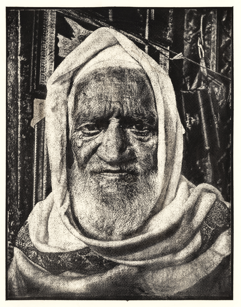

Until this week, that is. I've been doing a fair amount of work with the gumoil process over the last 3-4 months. While browsing the web for gumoil photographers, I discovered (a) that there aren't many that have made decent prints and (b) that there were at least a few mentions here at photrio.com. I've had some fairly decent success with the process (see the India Portraits on my website and I've posted a few on Instagram as well. Anyway, I'm back on this site to see if there are any connections to be made.
The Hat Merchant at the Delhi Jama Masjid (Gumoil)

Thanks! I do know several alt process photographers in the Northwest but I'm not familiar with the group and am curious to learn more. As an aside, I figured out how to add a photo have edited my post to include a gumoil photo.
I've done quite a few gumoil prints, but haven't made any for about a year. I have a few in my gallery here. It just didn't have the amount of detail retention that I so desire, and at the end of the day, the look wasn't for me. Then there's the yellowing from the oil paint on the back of the print that I found unsettling. Your print looks lovely... but sadly, the gumoil look is lost on the internet... just like my Carbon Transfer print relief. Please post more!

Yep. Gumoil has its challenges and seeing images on the Internet can be underwhelming. But, I like the crunchy texture of the prints. It's an unforgiving process if you want detail - but I'm printing big on 22x30" paper with an image size of about 16x21" or about equal to A2 paper. At that scale, I seem to be getting enough detail. You have to step back from the print to see the whole thing. And, I haven't seen the yellow on the back of the print but my oldest prints are only about 8 months old at this point.

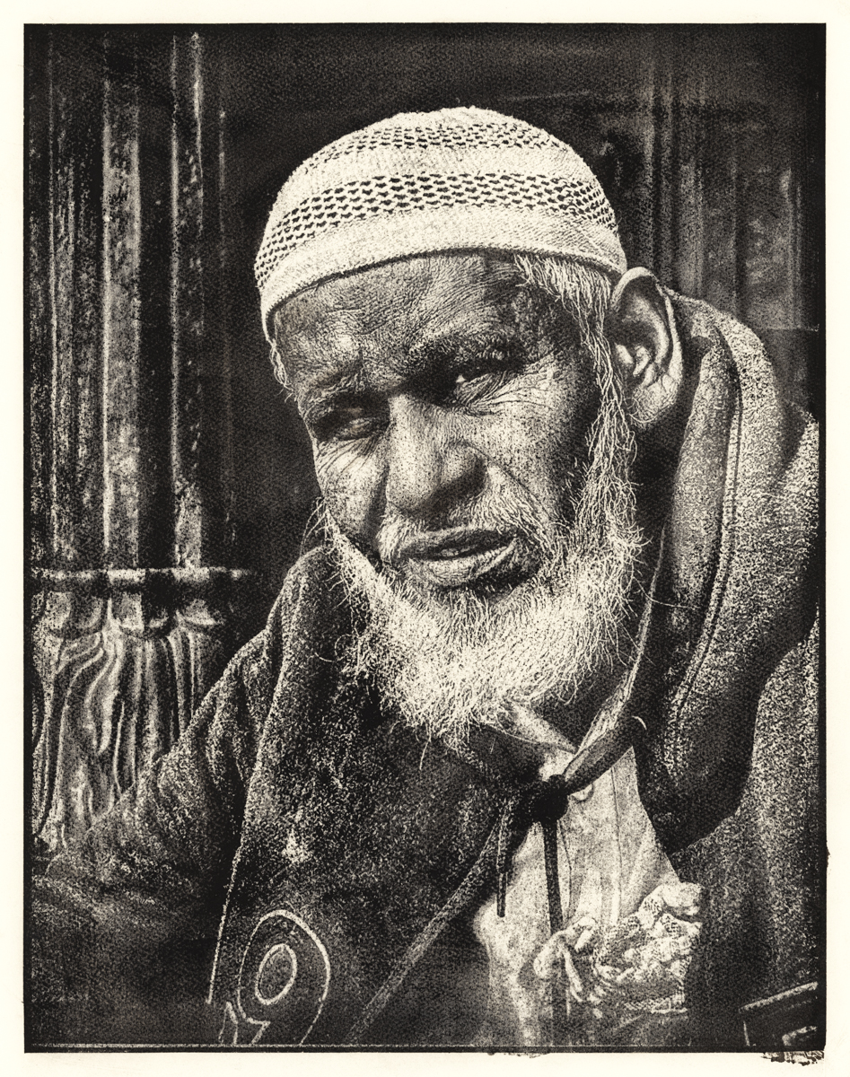

I've been using potassium dichromate and gum arabic (Bostick & Sullivan) mixed in a 1:2.5 ratio. I'm printing on Somerset paper that is 22x30" in size so I use between 8-10ml of emulsion per image. The oil paints I've used are Maimeri Classico with Ivory Black and Van Dyke Brown in roughly a 2:1 ratio. I use sponges to apply the paint mixture over the entire image surface and then also for the first removal after the water bath. And, then I use a foam brush for the detail work on the second removal and also through the two etching/clearing baths in order to clean out the last of the stain from the emulsion. The first clearing bath is a mix of potassium permanganate and glacial acetic acid and the second is a mix of sodium metabisulfite and sodium sulfite. Others have reported a yellow stain on the back of prints from the oil paints - but I haven't seen that yet and my oldest prints are now about 8 months old. It makes me wonder if the oil paint I'm using doesn't have that issue or if the two etching/clearing baths that I use have eliminating that downside.
Man In The Delhi Jama Masjid Mosque (Gumoil)
