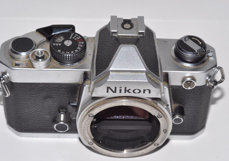

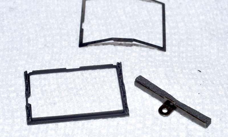

I don't like getting anything that dirty anywhere near my test equipment, so the first thing was to clean the camera. At the same time I replaced some of the deteriorating foam on the focus screen frame. This is a later FM in which the focus screen can be reomved from inside the mirror box.

The highest speed is just out of accepted tolerances. The slower speeds are fantastic.
At nominal 1/1000, the upper frame is -0.13 EV and lower frame is -0.05 EV compared to the middle. This is actually very good.
First curtain: 5.3 ms
Second curtain: 5.42 ms; both OK.
1s 0EV
1/2 0EV
1/4 +0.1EV
1/8 0EV
1/16 0EV
1/32 0EV
1/64 +0.1EV
1/128 +0.1EV
1/256 +0.3EV
1/512 +0.3EV
1/1024 +0.5EV
ic-racer
ic-racer
Feb 25, 2007
16,544
USA
Exposure meter, all within limits.
Brightness EV Error
EV5 0EV
EV9 0EV
EV16 +0.3EV

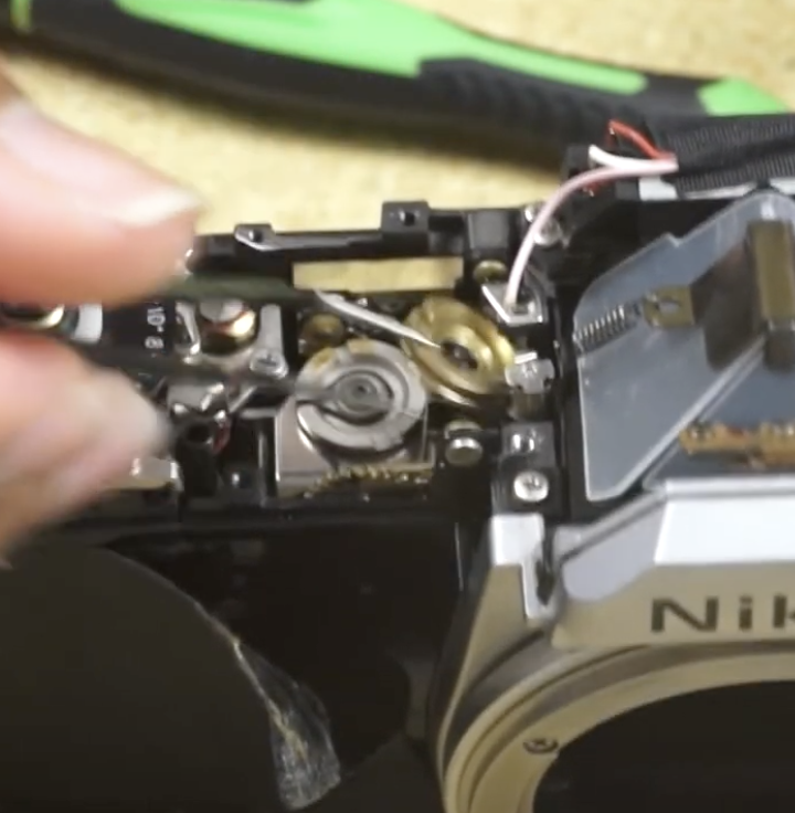

It's interesting to note that it took Nikon three attempts to get the FM right. I have the 3rd version with the first versions pentaprism (do to de-silvering) and knurled rewind knob installed on it. I also replaced the foam around its eyepiece while I was in there.
I have fitted the camera with a well-made custom grip and soft-release shutter button which has completely transformed its handling for the better.
One problem that I am a bit stumped on is that the shutter speed readout fails to go below 1/8 of a second.
Did you take the shutter speed knob and FRE assembly off and get the string for the speed readout around the wheel correctly afterwards?
