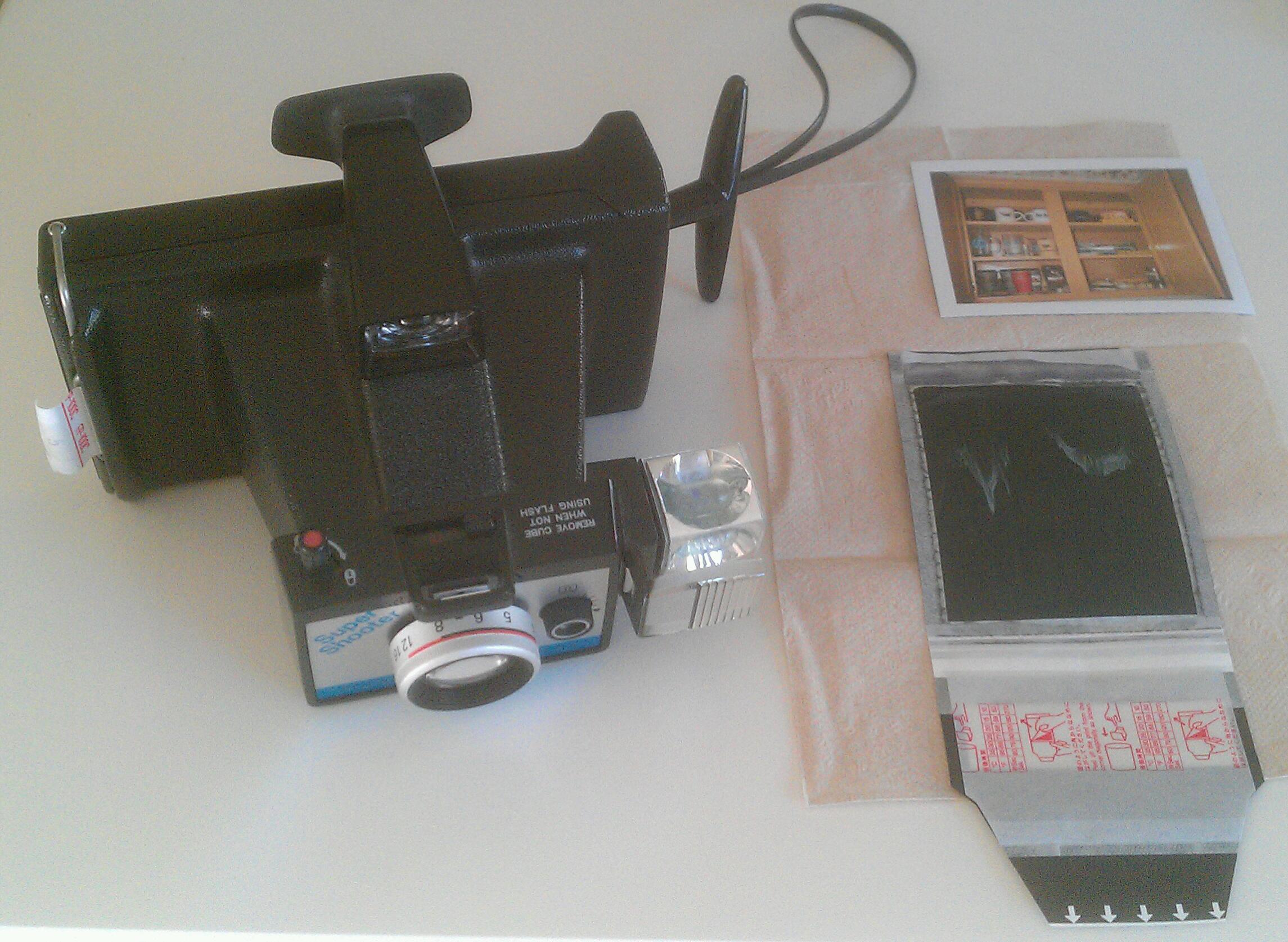

Pack film is "mechanically" complex to manufacture, assemble, and operate - it's like a 10-shot Grafmatic with tabs. You put this "pack" in the back of your Polaroid camera or holder, insuring that a fan of 10 little tabs and the darkslide tab stick out. Close the back. Pull the darkslide out a long, long, long way - because it's covering a lot of material . Trip the shutter. The first negative gets exposed and then you pull the first numbered tab and a larger separate tab sticks out. You pull that and it causes negative #1 and it's corresponding positive material to come together and then get squeezed through the rollers. You wait a specified time and then peel off the positive sheet. Only then can you see a few of the layers of paper and other things that's part of the sandwich of your first photo. Repeat for the next nine photos.
What it is:
I wish Fuji would have contacted Impossible before they scrapped their facilities and equipment, but they didn't. Impossible are probably the only ones who could recreate pack film today, but even they struggle trying to achieve a proper opacity layer and archival qualities that Polaroid had mastered in 1972 (SX-70 integral film).
The Chinese are capable of reverse-engineering pack film, but unless it's worth their effort financially it won't happen.
Fuji wasn't making money on pack film once third-world countries switched to digital for id's and stuff. So, they bailed out and devoted their resources elsewhere. I see Fuji pack film being offered from $50-$80 now that demand exceeds a dwindling finite supply. If Fuji had raised their prices from $12 (?) to $25, would that have saved it? Probably not.
