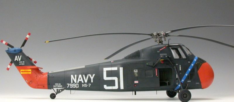

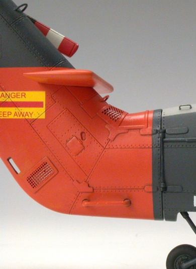

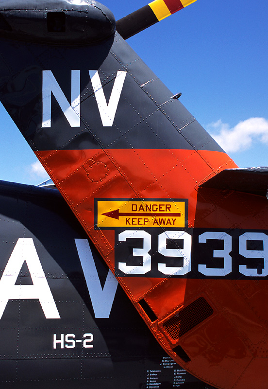

Sikorsky "Seabat" on flight-deck USS Intrepid ?
with regards:wink:
trendland
Mar 16, 2012
3,398
This was taken on the USS Midway here in San Diego. Don't recall the type of aircraft, though...
Understand - look at the helicopter tail section it is easy to identify :
compare !:wink:
with regards
PS : Sorry OP to come away a bit from the basic theme :D!
(I just wanted to give an example of a correct exposure:wink:)
