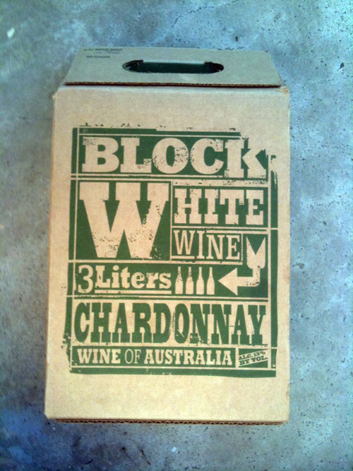

Out here in California, we have a grocery chain called Trader Joes. They have 3 liter wine in boxes for under $10 U.S.

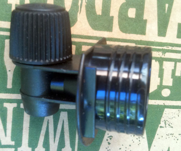

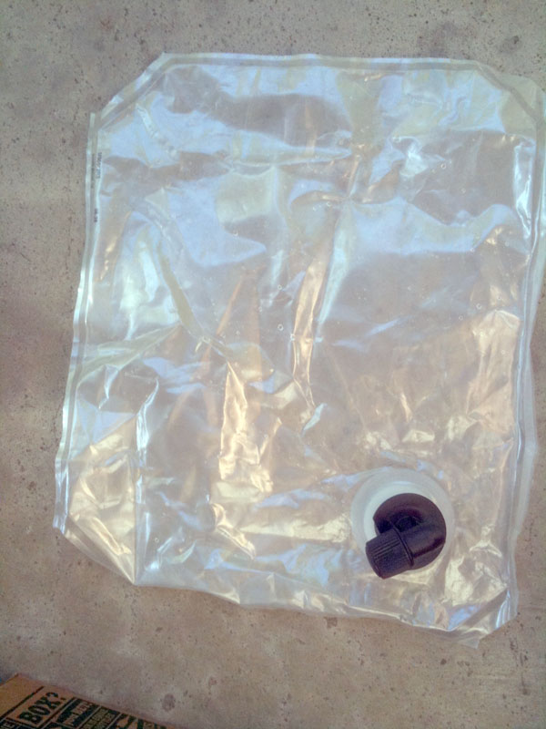

I've drank all the wine and I now have an empty box with a bladder and a spigot. I'm going to put some film developer in it. Do you think it's a good idea? The bladder is made of a double layer of polyethelene. Here are some pics. Here's a tip. The black spigot won't unscrew. You'll have to pull it out of the plastic collar. It's also fun getting the wine box empty!

Have you noticed that good wine is never packaged like this? Think about it! Cheap wine is intended to be drunk soon after it is produced. Polyethylene containers are porous to oxygen which is neither good for wine or developers.

I've been storing my Xtol, D76 and Dektol in these for years. The 5L Franzia ones actually fit a whole 5L batch of Xtol. No problems with storing the stock solution for beyond its specified shelf life, and Dektol stays fresh-colored to the very end so I assume there is no problem with permeability. Very convenient spout, too. You just yank the spout out of its socket to refill. It becomes easier to remove after a couple times.

Works well. Been using the local (Australian ones) which appear to be mylar with 3 layers of aluminised plastic. The Dektol is still good after a year. We don't have '2 Buck Chuck' here but the el cheapo wines have a use by date about 1 year from packing and even that stuff would soon show any signs of acetic acid. Since the bag collapses as you draw off the developer there is no air contamination.

I am a big fan of winebags but stick to the ones that look like silver bags. Without anything but gut instinct to guide me I have doubts about the keeping properties of the clear plastic bags.

This leads me to think that even though some PE bladders are gas permeable, I would think it's a better alternative that a glass bottle that is half filled with developer. The one I'm using has a double layer of PE.

The amount of oxygen in a half filled glass bottle is limited. Once it is used there is no more unless the bottle is opened again. However, oxygen is constantly passing through the polyethylene bag.
