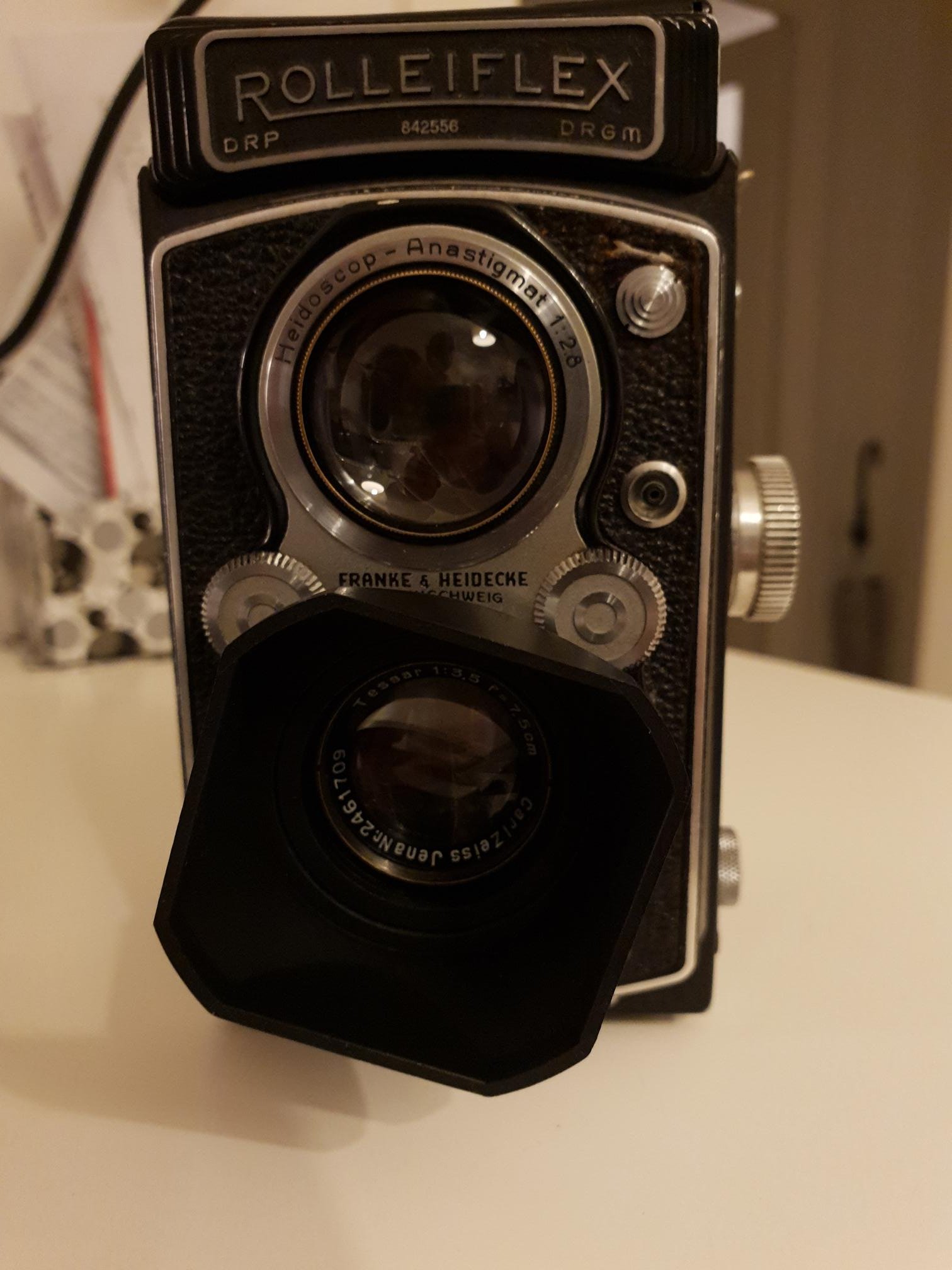

As original sun shades are very expensive, I got myself plastic one, for like 10$. But unfortunately it clicks on 45 degree angle as it should. Will this be a problem? I would not like to waste a roll of film for test, if someone already had this issue.
Thanks!

I bought the same shade and discovered that there is one position you can start it at that ends up properly squared, and with the logo facing upward. You need to play around with it a bit to find the correct start position. If I remember correctly, there's a white dot you line up with a mark on the lens housing or some such.

I put a mark on mine so I get it lined up properly the first time.
Although I never used it in that position... I can’t believe that it matters. There may be some minor vignetting of the viewing lens but that’s no problem.

I have a old Japanese version of the Bay 1 lens shade. If you have it on at 45 degrees as in the picture, it will probably vignette the corners of the 6x6 frame. You can verify this by opening the camera back, opening the shutter on B, and looking through the lens from the corners.
As others have said, there should be some orientation where it goes on properly. The bayonet fitting is roughly 3-fold symmetric, so just keep trying until you find the direction where it is lined up right.

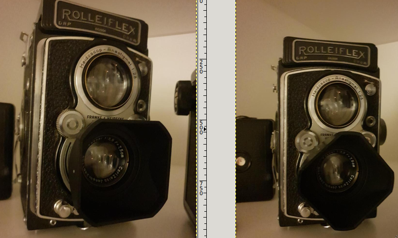

Yes it has a white dot. But from 3 ways - none is 100% right ... one is 45 degrees, second and third are like in the last photo - around 15 degrees off.
Hold it at that 45º over the viewing lens.
Thanks for the tip, will try tomorrow at bright light.

When checking for vignetting look at the lens center from the corner of the image frame at taking aperture. if you cannot see the aperture fully you have vignetting.
Being its an economy shade the mount is likely mismade, has a burr or bend in the mount preventing it from fully seating or the mount is improperly attached to the hood. Return it for another.

Does the shade need to be clicked into a stop? Those cheap shades are almost always off a bit like your second photo shows. But they will usually sit in the proper position. You could add a shim from tape or something to the back of the hood to make it stay oriented properly.
I would try to get it sitting square or use it in the second position, just slightly off-kilter.
The most extreme position to check for vignetting as shutterfinger described is at maximum close focus and widest aperture. If you can't see the hood looking through the back from a corner- line up the corner metal opening with the lens opening and see if the hood is obstructing any light- you'll be ok. Check the same extreme without the hood in place just to be certai nthat thereisn't some slight vignetting already occurring- not uncommon with wide open lenses.
