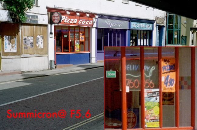

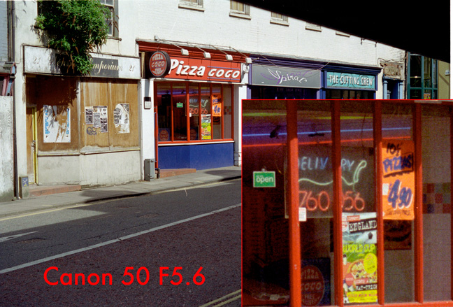

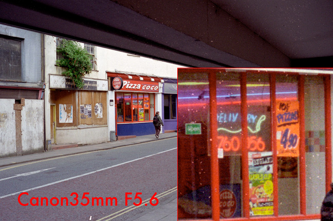

I would look at the Voigtlanders if you need a modern lens, my personal favourite is the Canon LTM 35mm F2 it is very comaparable to the CV Skopar (I think the CV is a derivative) and actually pretty good even compared to the Leica 35 F2 Summicron.
Here below is a 1960's rigid 50mm Leica Summicron
And below is the Canon 50mm F1,8
Here is the Canon 35mm F2
Obviously the 35mm has been blown up more, all pictures were taken on the same body with the same Fuji neg film within a 5 min period, so the lighting was similar (sun went in on the 35mm shot).
