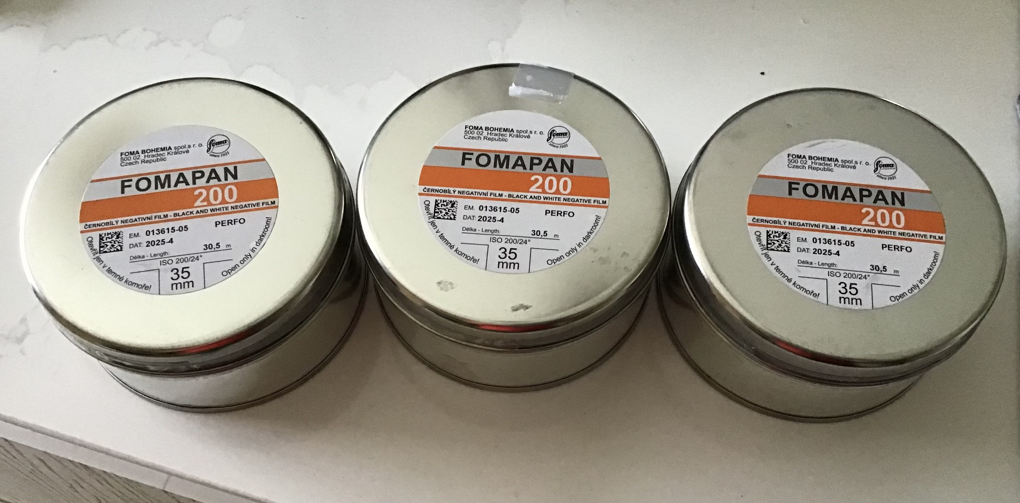

Fast - not the film but the delivery, based on this thread, my three cans of 100’ rolls of Czech Foma 200 ordered (said to be backordered) were just delivered, free shipping (and in two big packages, what’s the sense of that) from the Chattanooga TN distribution facility. Will advise if my amateur mitts can do anything w it. Each seems sealed properly 100% w factory tape but one has that small piece of regular dollar store tape pulling the top to the base. Odd.
