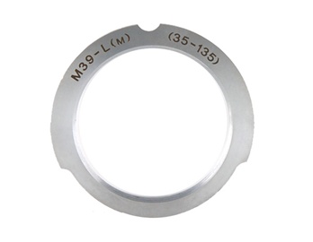

Ok, I asked, I was warned, And I went ahead and did it anyway :sad:
Let me make it simply ''DONT BUY THEM'' ''THER A SCAM'' ''unless your happy with no focus accuracy under 6ft''
It works like this, When a strapped for cash buyer sees two pieces of metal one for 12 euros and an other for 60 or 100, He will automatically assume that one would be unable to ''f#$@k up'' such a simple mechanism, No electronics, No AF motors, WRONG,
The threads don't evan nearly match up,
''your left with your aperture ring all on one side''
The focus is alright at infinity, but loses it at close range, I would rant about how anyone could when designing such a simple device that is going to be replicated thousands of times and fail to measure and test it, But I have came to two posable conclusions.
1... I will now have to buy the voigtlander adopter at a cost of 70? including post, add on top of that the two Chinese ones I bought and there shipping ''40 euro'' And I now have a total of 110 euros spent. ''win win for someone right?
2.. There was some poor slave designing my adopter getting a handful of rice a week. :unsure: So I feel kind of bad now complaining.
I have used the adopter to take photos and they work to an extent. But they are designed wrong.
Here is a image of the one I bought, Notice the style and layout of the wighting,
It comes in different focal lengths I have both nether work.
It appears to me that there are two different manufactures of chines adopters, But the one below is a dud.

OK, I'll give my experience, then. Over the last 40 years I've bought Leica rings, Voigtlander rings, and $7 Ebay rings. Except for the non-Leica ones having some sharp edges, having had maybe 6 or 8 Leica, 4 Voigtlander, and a half dozen cheapies, I've never had a bit of a problem with any of them.
If your lens focuses good at infinity, but not close up, it's not the adapter's fault! Don't blame the adapter for that.
I don't see a single thing wrong with the one in the photo. Perhaps you can enlighten us.
I hope no one takes your "review" too seriously!

I din't have problems with MiC ones for 50mm framelines. Not for Jupiter-8, nor for Summarit 50 1.5 wide open. I have tried several FSU and Leica 50mm lenses with MiC adapters. Works fine.
But with 35-135 it din't worked well. LTM lens would align on LTM body, but on M with 35-135 MiC, it will shift lens position. Hector 135, for example, will not focus on M body.

I have two Chinese LTM to M adapters. The first engages and locks nicely on M39 and M mount, and focus appears to be correct from minimum distance to infinity with various FSU lenses. However it gives some slack in the frame line lever when on the camera, so the bayonet dimensions are a fraction out, but not enough to deter use. The second is a different brand and I didn't get further than a few degrees of turn before abandoning the experiment. I'm sure it would have locked given sufficient force, but the effort was beyond my mechanical sympathies and would have had Wetzlar's engineers spinning in their graves.
It's the old story with cheap Chinese products and Soviet optical goods before them, get a good one and it'll be brilliant, but quality control isn't to the best western standards.

The one I have seems to be fine, though I've not used it with anything longer than a 50. My only problem with it was that the edges were almost sharp enough to shave with, but a few minutes with some Scotch-brite and a little emory paper in places took care of that.
The saying "you get what you pay for" is almost always true and high quality control costs money.

It may seem like a simple device but it needs to have tight tolerances.
A Ch one would not mount easily, ten minutes with a nail file fixed that. It was not my ring. It was ok otherwise.
If the rangefinder is ok at infinity but out close in it is more likely.
a) you are not using a collimeter or
b) your lens has a problem
c) your M4 has a problem
The moon is at infinity.
It takes me a weekend to get an M rangefinder near to factory accuracy, they are good for f/0.95 5cm.
Cowboys will tell you different.
There were two LTM setting standards the Leica lenses on Leica bodies have infinity at half one.
The Canon lenses on Canon bodies have infinity at 12:00. ( I think.)
Be careful when you buy lenses some are not compatible even if your M4 will accept any lens a late Canon LTM rather more picky.
Some Ms can be picky I've had new in box Leica asph lens fail to mount. I handed back to shopkeeper...
Only buy rangefinder kit when you can inspect and return. Most UK dealers (or EU) will allow immediate return, you get to pay return post.
Slagging of suppliers in general won't help... Some of the Ch rings are ok.

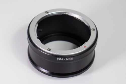

Im after getting some more adopters, So il give my thoughts on them too.:D
Olympus OM, to Sony NEX,
Im quite happy with this adopter, Its made of metal, And has a sufficiently tight tolerance, Altho if you fully tighten the lens on the focus becomes locked
''in practice this is not a problem but how it is there at all I have no idea'' ''and yes I'm referring to a bayonet mount lens:wondering:''
Some things puzzle me, like why they chose a rouge sand blast finish on the mount, But all in all its fairly good.

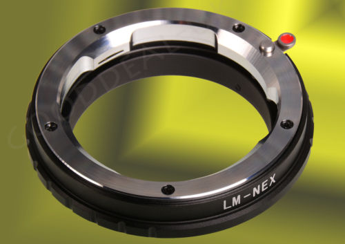

Leica M to Sony E.
The lens release button is metal, but is a bit fragile looking, And requires a bit of pressure to operate,
But it gets the job done,
mounting lenses is also quite stiff, But over all a good product at a good price.
