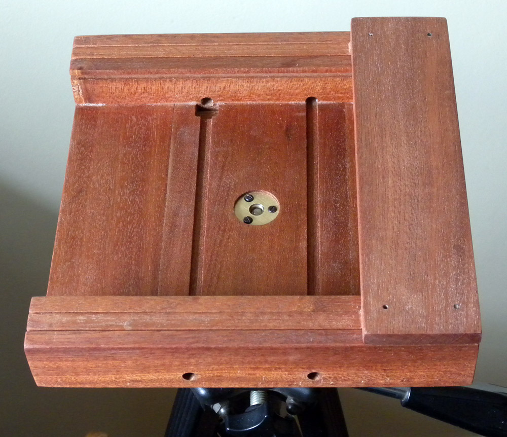

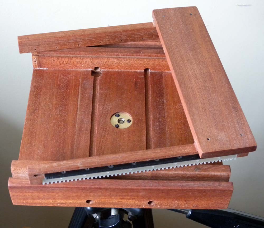

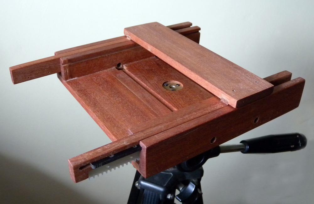

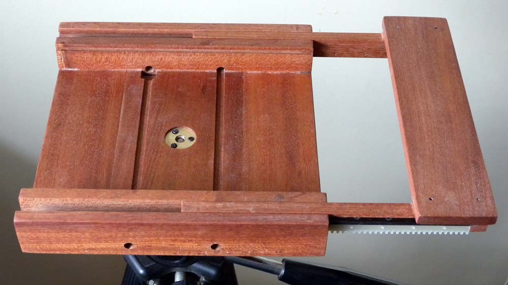

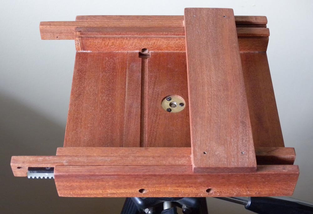

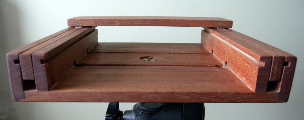

In the last few years I have started to build a few 5x4 cameras. My problem is finishing them!
I get to a point where I realise that I could have done something a better way and get annoyed with myself.
To that end, I have now started a fourth camera based on the Zone VI design with twin focusing racks.
Unusually for me, I have done extensive drawings to see if it's what I really want. I have a feeling that I might actually finish this one!
Here are a few pictures of the base of this one:
DSCN0192.jpg DSCN0191.jpg DSCN0193.jpg DSCN0195.jpg DSCN0191.jpg DSCN0194.jpg DSCN0197.jpg DSCN0189.jpg
Does anyone else suffer from this problem?
Steve.

I'm not really striving for perfect. I just get to a point where I say to myself "this isn't going to turn out quite how I wanted it" or "it would be better if I did it like this".
I tend to start things by building one piece then building the next piece to fit. Very unlike me, for this camera, I have made extensive CAD drawings and I only started to cut wood once I was happy that it was all going to work out.
I will probably finish one of my previous efforts as it was going to be a horizontal 5x7 with a 5x4 reducing back. I have already made the front and back for it and I have the bellows as that was the reason for making it. I have decided to simplify that one and build it as a monorail... but that will be after I finish this one!
Steve.

I have the same range. I like the Zone VI design with separate front and rear focusing racks rather than sliding the front standard to a position on the rack to suit the lens as is the case with most designs.

Back on topic, however; I was wondering if you could comment on a change in design I've made halfway through this:
I've decided that geared front focus is a bit of a waste. I've decided to have a manually sliding front. Similar in principle to the Chamonix-styled rip off design, but infinitely positionable via a slide (not pre drilled holes). I have an idea on how to lock this off as well.
I figured that I've never used both front and rear to focus, and being 8x10 the draw will be possibly too long to reach the front with long FL lenses. So, why not have a system where you roughly position the front and use geared focus on the rear?
Your thoughts?

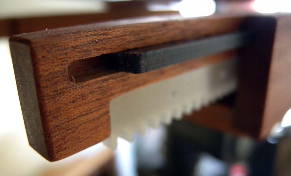

Well, I've sourced the rack'n'pinions. That was a bit of a sticking point.
Where are you getting yours from?
I'm making my own rack with work's CNC router (which cuts all the wood for me too!) and I am using Mod 0.8/32 pitch pinions from model racing cars.
Steve.
Steve.
Ronson Gears here in Oz. Lookng at 0.8x4mm brass set up. They initially offered me steel ".8x8mm. Too bloody heavy!
I'm also looking at using some Carbon Fibre rods to reduce weight and stiffen the extensions, as well as some CF sheet inserts in the base board.

I have the build your own bug, but I live in a small apartment so no power tools except a compact scroll saw and hand drill. My wood 4X5 contraptions have to be simple in the extreme. I try to work with hobby plywood and pre cut dimensional wood strips as much as possible.
If I was in that situation, I would look at having plywood laser cut by a steel rule die manufacturer. This is how the Bulldog kit was made.
I don't have much in the way of woodworking tools so I make cameras using techniques which I would usually use with metal and plastics. I don't have the facilities to plane and thickness wood so I buy it in already thicknessed to 9mm. Then I draw up the parts on CAD and CNC cut them.
