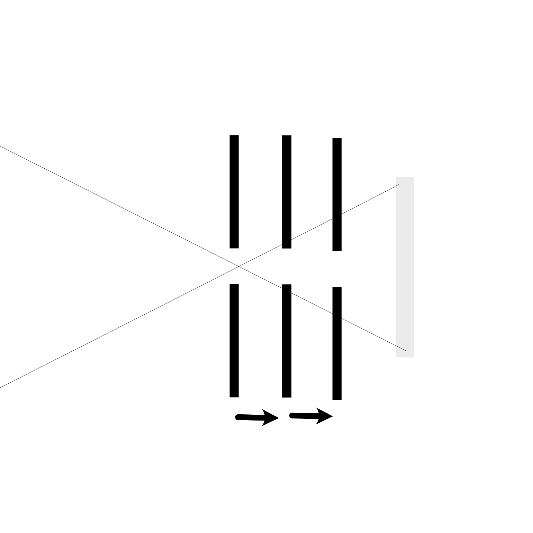

The effective aperture changes when the aperture position changes with respect to the source or target. This occurs during focusing and is independent of any 'inverse square' effect of on the spreading photons. It is a mechanical effect of a smaller aperture for the light through which to pass as the physical aperture approaches the negative when focusing a high magnification image.
Some more info here if not clear:
To satisfy the inverse square law with increasing magnification, the lens needs to be opened up to keep the same effective aperture, otherwise the image is dimmer than predicted by inverse square alone.
